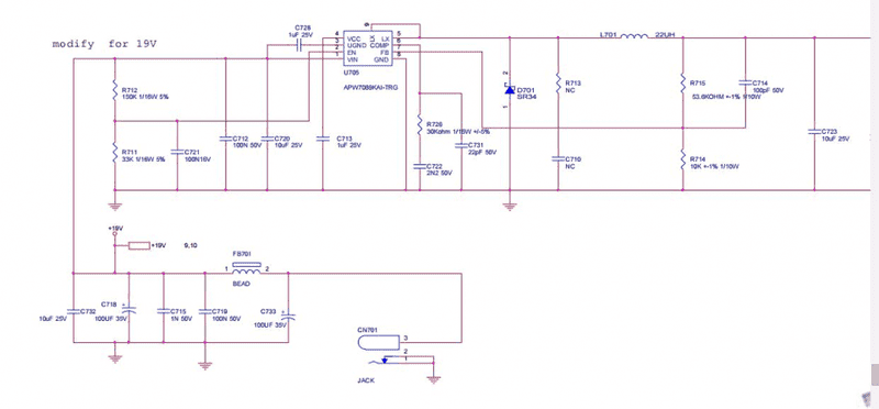

I've got two monitors I am trying to power with a battery. They accept 19V @ 1.3A each, and I'll have them in parallel off a single battery, so they'll need 19V @ 2.3A from the battery. I'm looking at http://www.hobbyking.com/hobbyking/store/uh_viewItem.asp?idProduct=56845. The specifications say 22.2V. Can I still use this directly with the monitors? Or would I have to use some resistors to lower the voltage before it got to the monitors?

I just looked at a similar type Acer service manual online. The 19 volt circuit is a direct tie into some of the electronics so I would suspect the nominal voltage tolerance would be fairly tight (maybe 10%). The safe way to handle the voltage difference would be to use a DC-DC converter to deliver the correct voltage to the monitor.
They sell fairly cheap ones designed for a car 12vdc battery input.
https://www.amazon.com/dp/B00S0UFR14/?tag=pfamazon01-20

Unfortunately the Amazon link is for 12V, not 22.2V, and I don't know enough to follow the circuit schemata you've got there. I found this DC-DC regulator on batteryspace, which I might be forced to buy given my time constraints and the current state of my project. This has a max throughput of 4A, which should be fine (the LCDs should draw 3.6A), so if I buy that and a power distribution board, everything with the battery I'm looking at should work, right?

That should work.
