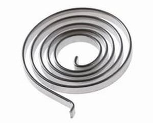

So masses on springs store potential energy. Height in a gravational field store potential energy for the mass there.So why isn't there a potential energy stored inside rotating objects? Surely there are ways to translate the rotational energy to kinetic. Its kinda like a spring. If a set down a fast spinning object, it will roll forward slowing its rotation down and speeding up its linear motion. One type of energy is transferred to another.
See torsion spring. https://en.wikipedia.org/wiki/Torsion_spring
