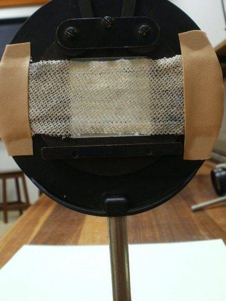

I attempted to photograph it in the lab using a sodium spectrum tube positioned about 14 meters away and the small piece of cheese cloth about 3 meters away (the threads in the cheese cloth is not a completely regular pattern though) - no success. With my eye I could see some of the fine structure of the cloth, but I remembered seeining the curtain weave much more enlarged previously. I am getting the idea that one need a large sheet of the material in order to observe the effect.
