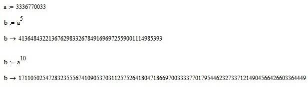

Hi, I've been through the help files and demos but one question which I can't find the answer to is destroying my confidence with this toolbox.
If I write: a = fi(3336770033), why does it write 3336830976? I can't figure out why it's losing my number. I don't need any moving decimals, all I want to do is multiply this number a few times, and get the result with complete accuracy. 64 bits is not enough so floating point won't do.
Am I using the wrong toolbox for this purpose?
Thanks

According to the documentation, the default word size for the fixed point function fi is 16 bits.
If you want to multiply large numbers and retain full significance then you need the Symbolic Toolbox. I believe Matlab uses MuPad as the engine for its Symbolic Toolbox, which is the same as Mathcad ... I've attached a screenshot from Mathcad - is this what you want to do?

As you can see in your own screenshot, if you don't tell Matlab what to do with the representation of the numbers, it does just fine, showing as many accurate digits as you want.

I'm not sure which message you are replying to here, but just in case its mine (because of mention of the screenshot) I just want to make clear that the screenshot is of Mathcad not Matlab. Mathcad has a version of the MuPad symbolic built into it, whereas the MuPad Symbolic Toolbox is an add-on for Matlab. Matlab normally operates at IEEE double floating-point precision giving something like 52 bits for the mantissa? ... or near enough for Government work, I think ... the relevant point being that standard Matlab will hit a precision limit pretty quickly when multiplying large (number of digits) numbers together.
Hmm, ok, thanks. I'm still not sure why fi(x) doesn't just give x, it's not like it can be limited by the bit size since the (incorrect) 3336830976 is the same length as my input 3336770033.
I'll give the symbolic toolbox a go, thanks.
Look at the two numbers in hex rather than decimal ... you should find that the 'incorrect' number has a string of zeros at the end, implying they've been lost as expected.
