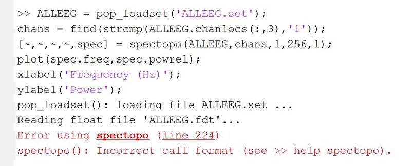

Well. I need to use Welsh FFT plot using my 1000Hz bandwidth data (GDF format) and the EEGlab running under Matlab can load it and then use its ALLEEG variable to do the Welsh plot (like FFT without the noise floor detail and using other ways of computing the bins).
I found this website and tried following the codes for plotting Matcad FFT Plot using ALLEGG in EEGLab
https://devcodef1.com/news/1232023/matlab-fft-plot-alleeg
After loading EEGlab and the GDF data. I tried running the codes in the web site:
Code:
ALLEEG = pop_loadset('ALLEEG.set');
chans = find(strcmp(ALLEEG.chanlocs(:,3),'1'));
[~,~,~,~,~,~,~,~,spec] = spectopo(ALLEEG,chans,1,256,1);
plot(spec.freq,spec.powrel);
xlabel('Frequency (Hz)');
ylabel('Power');
But the codes returned errors (see attachments)
"Error using spectopo Too many output arguments."
When I changed the [~,~,~,~,~,~,~,~,spec] to [~,~,~,~,spec]. No more error. Why is there no more error with only 4 "~,"?
Instead there is another error: (see screenshot).
When I checked out line 224. Here is the inside of it.
What kind of error is that and how do you fix that?
Thank you.

Even if I used 5 arguments. It is produced the error

Have you been able to try the "help spectopo" command line prompt?
It should tell you more definitively what the expected return vector is. This may be a vendor or version issue, i.e., you're seeing the Spectopo online reference for a different version of Spectopo than the one you are using.
With respect to line 224, the if expression indicates it has something to do with the "data" variable being non-numeric. This might imply that the inputs you give to spectopo are somehow suspect ie bad data, or wrong dimensions or wrong values...
The second error is about the input. In your case that is the 'ALLEEG' variable. It is some numerical data but apparently spectopo expects something else (a structure?)
Anyway, if you type
>> help spectopo
Or look at the top of the spectopo.m file (which is the same...) you should be given more hints on how the input data should be formatted. Probably the spectopo function got updated but the example did not...
