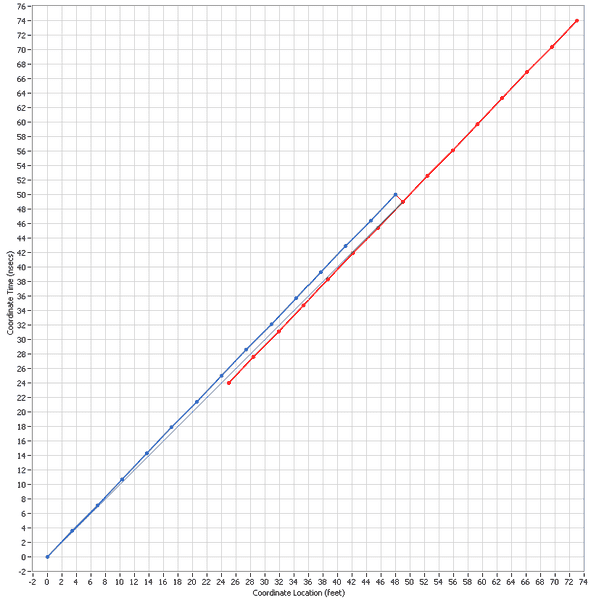

In order to see how Special Relativity depicts the situation when "The Flash" is traveling at a very high speed (I picked 96% of the speed of light) we use the Lorentz Transformation. The net result of this is shown in this diagram:
Now you can see that "The Flash" is chasing the thin blue flash of light. He's right behind it for a distance of 47 feet but then it hits the mirror and almost immediately returns to him as the short thin red line. You will note that his time is running slower than it was before--this is Time Dilation and you will not that the mirror is closer to him--this is Length Contraction. The net result is that his measurement comes out the same. Does this make sense?
Note that it won't make any difference if the light was started by "The Flash" with a flashlight carried with him or if the light came from an external source that is stationary as long as it can start his timer when it passes by him on the way to his mirror.
