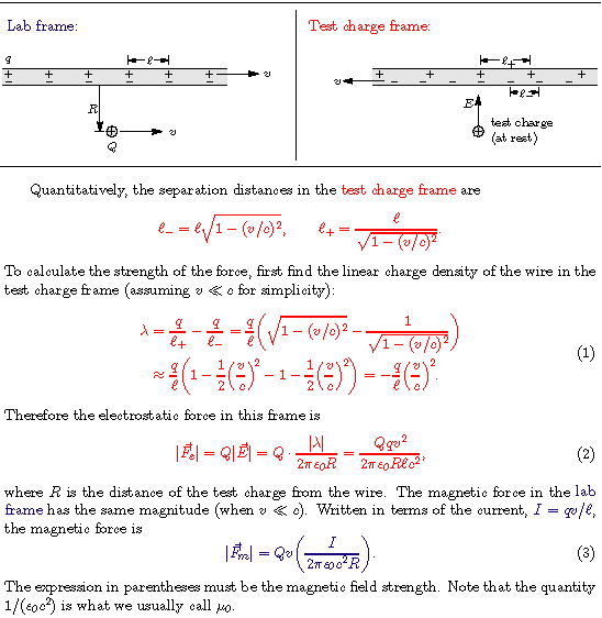

Here's the text and graphic discussing why a charge moving parallel to the wire will experience an attractive force when viewed in the charge's rest frame (where it experiences no magnetic force since its velocity is zero), if you just want a conceptual explanation you can skip the equations:
Shown below is a model of a wire with a current flowing to the right. To avoid minus signs I'm taking the current to consist of a flow of positive charges, separated by an average distance of l. The wire has to be electrically neutral in the lab frame, so there must be a bunch of negative charges, at rest, separated by the same average distance. Therefore there's no electrostatic force on a test charge Q outside the wire. What happens, though, if the test charge is moving to the right? For simplicity, let's say its velocity is the same as that of the moving charges in the wire. Now consider how all this looks in the reference frame of the test charge, where it's at rest. Here it's the negative charges in the wire that are moving to the left. Because they're moving, the average distance between them is length-contracted by the Lorentz factor. Meanwhile the positive charges are now at rest, so the average distance between them is un-length-contracted by the Lorentz factor. Both of these effects give the wire a net negative charge, so it exerts an attractive electrostatic force on the test charge. Back in the lab frame, we call this force a magnetic force.
Derivation page: two diagrams labeled Lab frame and Test charge frame showing a charged wire with plus and minus charges and a test charge Q, followed by equations (1) to (3) for electrostatic and magnetic force in the test charge frame.
By the way, it's remarkable that we can measure magnetic forces at all, since the average drift velocity in a household wire is only a snail's pace: v/c is typically only 10^-13, so the Lorentz factor differs from 1 only by about one part in 10^26. We can still measure this effect because the total charge of all the conduction electrons in a meter-long wire is tens of thousands of coulombs; two such charges separated by only a few millimeters would exert enormous electrostatic forces on each other.
You can repeat the preceding calculation for the more complicated case where the test charge's velocity differs from the average drift velocity of the charge carriers in the wire. Their velocities can also be opposite in direction. In each case, you still get the correct expression for the magnetic force on the test charge. The case where the test charge moves perpendicular to the wire is still more complicated, but we can understand it qualitatively after digressing to consider how electrostatic fields transform from one reference frame to another.

From the above explanation, I think the idea is that the protons are at rest in the wire's rest frame while the electrons in the wire are moving in this frame (the author just talks about 'charges' rather than protons and electrons, but since real flow of charge in wires is in the form of electrons, I assume when he says 'To avoid minus signs I'm taking the current to consist of a flow of positive charges', that means he's labeling the electrons as positive charges and protons as negative ones), the Lorentz contraction between them will be different in the rest frame of the charged particle moving relative to the wire--the page makes the simplifying assumption that the charged particle outside the wire has the same velocity as the electrons in the wire, but then adds "You can repeat the preceding calculation for the more complicated case where the test charge's velocity differs from the average drift velocity of the charge carriers in the wire. Their velocities can also be opposite in direction. In each case, you still get the correct expression for the magnetic force on the test charge."

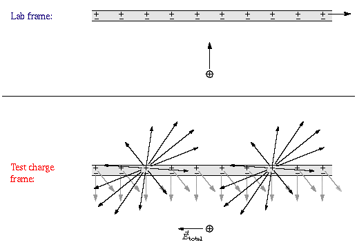

A Charge Moving Perpendicular to a Wire
With all this in mind, let's now consider our wire again, but with the test charge moving directly toward it.
Two diagrams of a charged wire in the lab frame and the test charge frame, showing rows of plus and minus charges with electric field arrows around a test charge and a total field E-total arrow.
In the frame of the test charge the wire is moving downward. The negative charges in the wire, which are moving straight down, have their electric fields distorted as shown previously, but these fields are symmetrical from left to right so they exert no net horizontal force on the test charge. The positive charges in the wire, however, are now moving diagonally, so their fields are distorted as shown above. At the location of the test charge, the field of the positive charge to the right is stronger than that of the positive charge to the left, so the test charge feels a net force pushing it to the left.
In summary, we can account for the direction of the magnetic force on the test charge no matter which way it's moving, and this motivates us to introduce a magnetic field vector that points into the page, with the force given by a cross-product of v and B.

Thanks guys! The apparent DIAGONAL approach of the moving charges in the wire was the missing clue for problem #2. I knew that, but hadn't connected it up with this problem. I will have to go back and review - I assume that it tilts in the right (correct) direction to cause the correct force. Among all the amazing things about this is that the magnitude of the force on the test charge, i.e., q |(v x B)| is the same for both parallel and perpendicular trajectories w.r.t. the current flow in the wire. Yet the SRT effects causing the forces seems quite different. I wonder if that is an amazing coincidence or some more subtle connection...

No, in the wire rest frame the electrons are arranged horizontally and moving right and the test particle is moving straight up, which is not equivalent to saying there's a frame where the electrons are arranged horizontally and moving straight down and the test particle is moving left, which would be like what the diagram shows (of course you could find a frame where the test particle was moving left, but although I haven't done the calculations I would guess that in this frame the angle of the electrons would be skewed from the horizontal). Think of it this way, in the wire rest frame the protons are at rest and arranged horizontally while the test particle is moving straight up, so it should make sense that in the frame where the test particle is at rest, the protons are still arranged horizontally and moving straight down, right? Well, it's impossible that in the test particle's rest frame, the protons could be arranged horizontally while the electrons could be skewed--that would prevent each electron from passing each proton in turn, but those are local events which all frames must agree on. So, if the protons are arranged horizontally in the test particle rest frame, the electrons must be too.

They all move diagonally in the test charge's frame, but I was talking about their arrangement at any single instant in the test charge's frame. Schroeder does show them arranged horizontally at a single instant, unlike with the rod that becomes skewed from the horizontal in section 4 of the relativity of simultaneity page which exmarine was referring to.

Which figure are you talking about? In all those figures, which represent a snapshot of positions at a single instant in some frame (along with arrows representing instantaneous velocities and forces at that instant), the position of the protons is always such that if you draw a line that crosses through all of them the line would be horizontal rather than skewed, so they aren't "rotated" in the sense I was talking about, although their velocity vectors may point at an angle.
