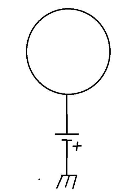

Can the magnetic and electric potentials (A and φ) be fixed to zero, or at least some constant value in a region of space? Naively, I'd think something like this might work (a hollow conducting sphere connected to a voltage source connected to ground, would the potentials inside the sphere be constant?):
The potentials are only physical up to gauge equivalence. Hence, they cannot be uniquely determined by physics alone without also adhering to some gauge fixing conditions. This also means that the question in itself is ill defined.

I take your point, but wouldn't the potentials equaling one constant value in one gauge equal another constant value in another gauge?

Can you please explain why?

Consider ##A'^\mu=A^\mu+v^\mu## where ##v^x=y## and all other components are zero. The Lorenz condition is that ##\partial_\mu A^\mu=0##, which is satisfied by ##A'^\mu## if it is satisfied by ##A^\mu##, since ##\partial_\mu v^\mu=\partial y/\partial x = 0##, but ##A'## is manifestly not constant if ##A## is. And this is in the same gauge.

Suppose that ##\vec A## is a vector potential of ##\vec V##, i.e., ##\vec V = \nabla\times \vec A##. Then, if we let ##\vec A' = \vec A + \nabla \phi## for any scalar field ##\phi##, then ##\nabla\times \vec A' = \nabla\times(\vec A + \nabla\phi) = \nabla\times\vec A = \vec V## so ##\vec A'## is also a vector potential of ##\vec V##. As long as you pick ##\phi## such that ##\nabla\phi## is not constant both potentials cannot be constant.
