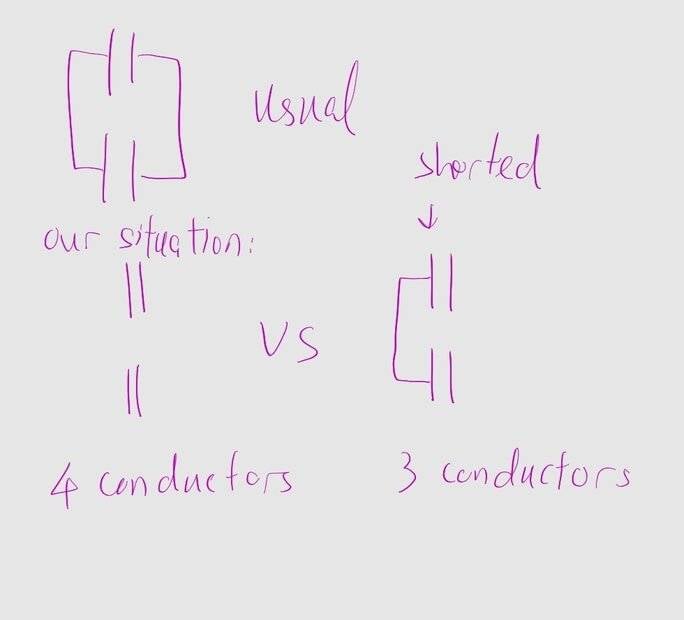

Electric potential = "absolute potential"
Textbooks usually connect both ends of two capacitors, of different voltages, in parallel. What would happen if we only connect one end of the capacitors? Perhaps we would have to solve for Maxwell's coefficients of potential for these two cases (to transition between both)
Right?
Here's a picture
Hand-drawn sketch comparing two capacitor configurations: on the left, a usual parallel pair with both ends connected, labelled "usual"; below, "our situation" with two plates stacked and no connecting wire, labelled 4 conductors; on the right, a capacitor with one plate pair shorted, labelled 3 conductors.

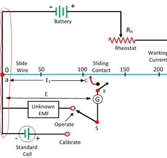

----> what would happen if we connect batteries in parallel, or that only 1 terminal is shorted. Assume that they have the same potential difference, but that they have different electric potential. Perhaps one realization (potentiometer) (circled red part):
Circuit schematic of a slide-wire potentiometer: a battery and rheostat feed a slide wire marked 0 to 200, with a sliding contact, galvanometer G, switch S, an unknown EMF, and a standard cell with Operate and Calibrate terminals.

In order to investigate electric potential, you should let us know how much charges are on the plates.
For an example if there is no charge at all, potential is zero everywhere.
With respect, the potential is constant everywhere and we call it zero by convention

The value of the electric potential is defined to within an arbitrary fixed constant and therefore only the differences in potential matter.
The potential of the planet Earth is often defined as zero to make the arithmetic easy.
There is no such thing as an "isolated" object or circuit. One can define the capacitance C of a isolated sphere only by assuming it is electrodynamically connected to the rest of the universe and then $$\Delta V \equiv \Delta Q /C $$ and Q is charge that has been separated from the universe to the object. Usually the rest of the universe is represented by a very large encompassing sphere. For lumped circuit theory the myth of isolation is tacitly assumed sometimes with bad result (as Prof. Walter Lewin marvelously demonstrated )
One could use Maxwell's coefficients but the rest of the universe may need to be included for any meaningful results to obtain. At some level of complexity, the lumped circuit model is probably not the place to start: better to solve Maxwell Equations directly using other approximations as needed.
They won't be different for long. Current will immediately flow to redistribute charges to equalize the two voltages. I don't think you'll see this question too often since it's sort of a trick question with a solution that requires some assumptions about the connecting inductance, oscillations, and energy radiated away as the charge is moved.
Since you drew this as a lumped element circuit then the answer for the usual case is that you will have the equivalent of a single capacitor with charge Q1+Q2, voltage V1=V2, and capacitance C1+C2. The charge will be redistributed to equalize the potential. For the "3-wire" case, you will have two capacitors in series which is equivalent to a single capacitor with total charge Q1+Q2, voltage V1+V2, and capacitance C1⋅C2/(C1+C2). Of course there will be no current flow, except to equalize the charge on the middle plates (which are eliminated in the single capacitor equivalent).
Yes, I think so. As @hutchphd said, I don't think you're really asking about a lumped element problem, which is always a huge simplification of the real world. Maxwell's equations are required when the geometric details matter.
