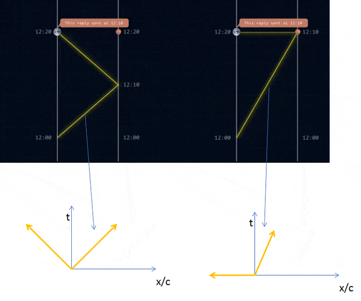

  • #103
HansH said:
then there should be something underlying that I do not catch at the moment. so how can we get that clear
Perhaps (not certainly) the issue is that you don’t fully recognize the anisotropic one-way speed of light as a simple coordinate transform. You appear to have some proficiency with mathcad. Perhaps you should implement the coordinate transform posted previously and play around with it to convince yourself that it does indeed change the one way speed of light but not the two way speed of light.
  • #104
HansH said:
things like laser beams interfering
There is the same argument: In the above cited transformation, only the time coordinate gets transformed. The spatial coordinates stay the same and therefore also the (x,y,z) coordinates of each part of a static interference pattern.

at this moment I am mainly digesting the info I get from you, but perhaps it makes sense for the proper understanding to verify if next fragment of this movie is correct:
because of they say that you receive the light from one direction istantly and from the other direction at c/2 you see the complete universe as is it now in one direction and a it was far in the past in the opposite direction. so is this a coordinate transformation or real speed of light using same physical coordinates (as he looks on both directions using coordinates as we measure on Earth so suppose they are the same)
edit: because if it is only based on a coordinate transformation, I could use another transformation and this would mean for the movie that what I saw in one direction first seeing Mars instantly then changes into seeing Mars 20 minutes ago, so that would means I invented a time machine so could not be true.
  • #108
Yes, despite the wonderment in his voice as he talks about this topic, it is nothing more than a coordinate transformation. There is no physics involved.
This is one of his worst videos ever. Not that what he says is wrong, but he leaves out the most important fact (that it is just a coordinate transform) and speaks in a way that makes the audience think he is talking about some mysterious unknown physics instead of some completely understood and mostly useless math.

  • #109
This is because he has applied a coordinate transform such that "stuff hapenning now" is defined to be exactly what he sees in that one direction (and stuff he hasn't seen yet in others).
He hasn't changed what he sees, he's chosen to change how he interprets what he sees.

I should add that I think the ##c_+=\infty##, ##c_-=c/2## case is on rather dubious ground because one of your "spatial" coordinates is lightlike. There's nothing wrong with it mathematically, but it has even fewer of the properties of a frame (depending on your definition of "frame", of course) than the ##c<c_+<\infty## cases have.
  • #111
At about 15:45 in this video he asks: "If it makes no difference to physics, then what is the point of talking about it?". Good question!
  • #112
