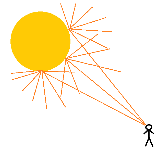

I guess you are imagining something like this:
From which you have inferred that each point of the Sun's surface emits light only in the direction normal to the surface. As explained above, that is not the case.
@PeroK: Images stick much more than words, a wrong image easily sticks and does the opposite of what you wanted.
Here is a graphical explanation of my previous post. Every point on the surface radiates in all directions, only a tiny fraction of that reaches our telescopes/eyes - but a tiny fraction from everywhere does. Distances and sizes not to scale ;).
The fraction reaching a telescope or an eye is even smaller by many orders of magnitude.
