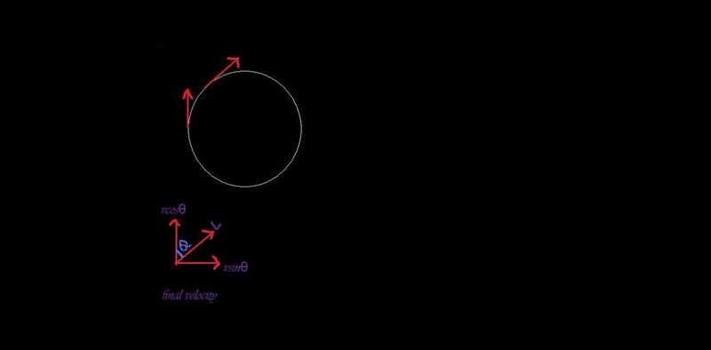

I was trying to prove that radial acceleration of a body moving in circle is v^2/r.
For uniform speed i came up with this 2v^2(icap-jcap)/rpi as radial acceleration
If icap-jcap=pi/2, acc=v^2/r

I get change in velocity:
[tex]\frac{( sinθ \hat{i} + ( cosθ - 1 ) \hat{j} ) v^2}{θr}[/tex]
where θ is change in velocity and in radian and less than pi/2, speed is constant and body starts moving from
[tex]v\hat{j}[/tex]
[tex]v\hat{j}[/tex]
Excellent. Now take the limit as θ approaches zero.

Your sign looks wrong on the sine term, and you should really have Δθ instead of θ. But, otherwise it's OK. So you should have:
[tex]\vec{a}=\frac{( -sinΔθ \hat{i} + ( cosΔθ - 1 ) \hat{j} ) v^2}{Δθr}[/tex]
You basically did the vector differentiation correctly. Now, take the limit as Δθ approaches zero.
Lim(sin(Δθ)/Δθ) as Δθ approaches zero is 1
Lim((cos(Δθ)-1)/Δθ) as Δθ approaches zero is 0
So:
[tex]\vec{a}=- \hat{i}\frac{v^2}{r}[/tex]
This is the acceleration vector, and it's pointing toward the origin (as it should).

i don't understand how sinΔθ icap is negative.
if the angle is less than 90 degrees shouldn't sintheta and costheta both be positive?
clearly sinθ is positive?
  • Black background diagram with a white circle and two red arrows tangent to its edge, one pointing up and one pointing up-right; below, a purple-labelled vector diagram with axes labelled v cos θ and v sin θ, a resultant v, and angle θ.
I'm sorry. I was thinking of it going counter clockwise starting at (r,0). The way you have it drawn is consistent with your equation. And, as your result indicates, it should be a +i unit vector (which points at the origin).
