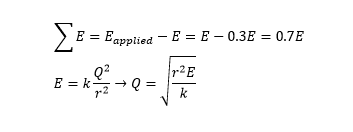

A capacitor connected to a battery initially holds a charge of +q on its positive plate and -q on its negative plate. The electric field between the plates is initially E. A dielectric material is then inserted that polarizes in such a way as to produce an electric field of -0.30E (where the - sign indicates that this field opposites that of E). Determine the new charge stored on the positive plate.
Eo-E=Ef
E=kq^2/r^2
I did my work on Word using the equation tool just to make the notation format easier to read.
Is my logic correct here?
Any help would be greatly appreciated! :)

The equation in red is the Coulomb force between two equal point charges. It is not electric field, and it is irrelevant to this problem.

Oh duh, it's just q from the source, not q^2

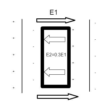

Does this image depict what you're describing correctly?
deleted
Yes.

Your sketch in #16 suggests you are assuming that the added material occupies less than the full gap between the plates? However, this fraction doesn't seem to be specified.
You know that E=E1-E2, as your picture shows. E2=0.3E. The new surface charge corresponds to the field E1, σ'=ε0E1. So what is σ' in terms of σ?
That's true. I made the assumption because all of the examples that our professor has mentioned has been when there is some separation between the two. But the question never suggests that there is any.

Look at your picture. The actual E is E = E1-E2, and E2=0.3 E.

Right, so then it would be σ'=0.7σ=0.7ε0E1.
