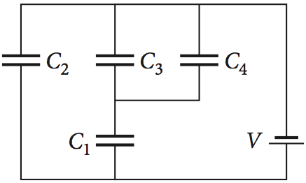

i just want to simplify this circuit so i can find the voltage across Capacitor 3.
c1= 5.3 μF c2=1.2μF c3=1.3μF c4=9.4μF
Vbattery=20V

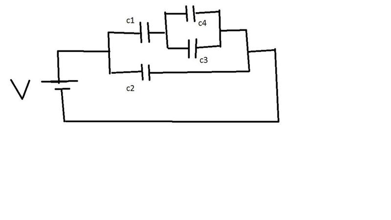

Is this picture I made the equivalent of the circuit above??
hi delgeezee! :smile:
yes …
if you flip the top structure through 180°, it makes that fairly obvious :wink:
