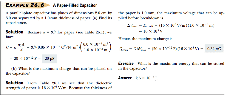

REFER TO ATTACHED SCREEN SHOT
My discrepancy is with the last question labeled "Exercise" (What is the maximum energy that can be stored in the capacitor?).
Since the max voltage is 16000V = 16000 J/C, why is multiplying the max voltage by the max charge (3.2 e-7 C) incorrect?
  • Textbook page showing Example 26.6, a paper-filled parallel-plate capacitor: worked solution computing capacitance as 20 pF and maximum charge as 0.32 µC, with an Exercise asking for maximum stored energy and answer 2.6 × 10⁻³ J.
Because were you to start drawing off charge, the capacitor voltage would drop, so you don't have available that amount of charge at the max charged voltage.
