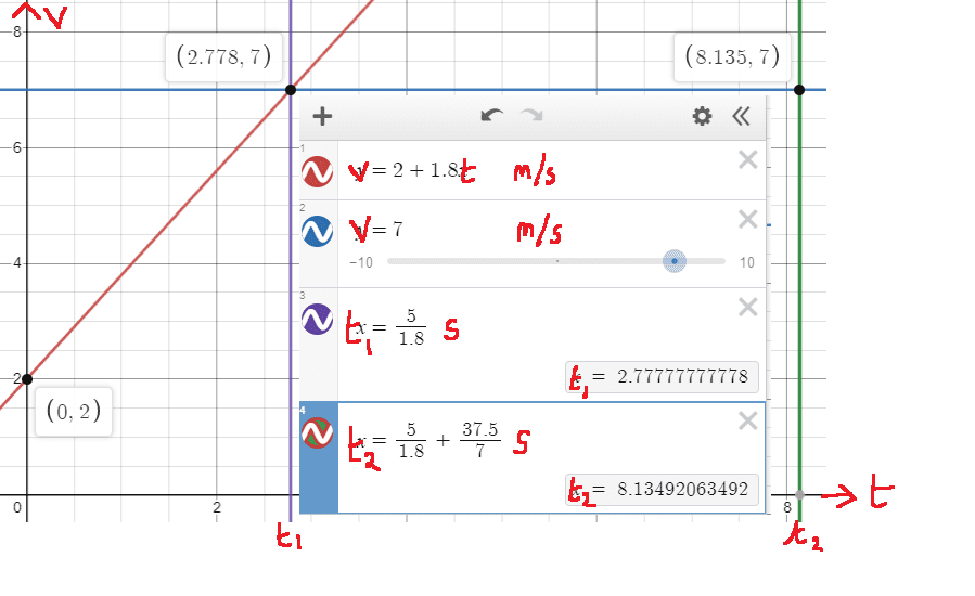

Relative velocity problem. Car traveling with initial velocity of 2m/s 50m behind "stationary" truck. Accelerates at 1.8 m/s/s till reaching 7m/s and maintains this until level with the truck. Area under graph up to t1 is 12.5m and 37.5m between t1 and t2. Simply add 18t for the actual displacement of car at t1 and t2 respectively.
Relative Velocity vs Time graph:
https://www.desmos.com/calculator/rgbooatiss
Relative Displacement vs Time graph:
https://www.desmos.com/calculator/ophyml0qrd
