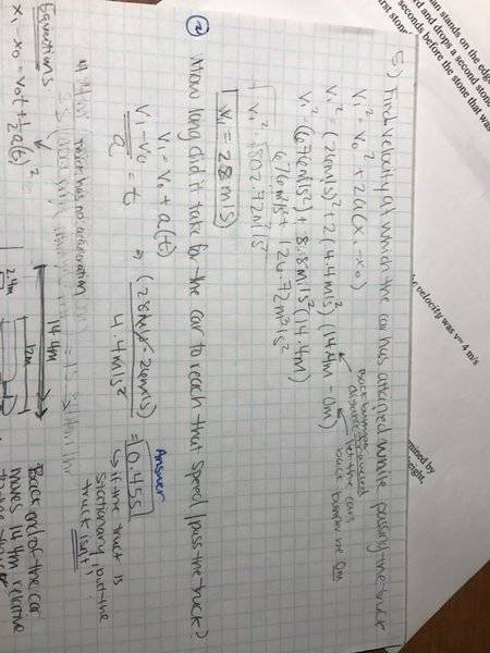

A car, length 2.4m, traveling at 26m/s wants to pass a large truck, length 12m, also traveling at 26m/s. If the car can accelerate at 4.4m/s2, how much time will it take the car to pass the truck (note the back of the car has to be in front of the truck)? How far will the car have traveled during this time? How much time did it take the car to pass the truck?
v12 = v02 +2a(x1-x0)
v12 = v02 + a(t)
I started off with plugging in the numbers in the first equation to get v1 and then plugged that in the second equation to get t.
v12 = (24m/s)2 + 2(4.4m/s2)(12m-2.4m)
(≈26m/s)=(24m/s)+(4.4m/s2)(t) which gave me t ≈ 0.39s
but I feel like that only gives me the time it takes to speed up to the truck and not actually pass it. So then I arbitrarily used 13m and inserted that in the first equation as x1 instead of 12m since 13m is further than 12m but that still gave me ≈26m/s which is the same velocity that the truck is driving so I wouldn't think it would pass the truck either, t ≈ 0.42s in this case.
I appreciate any help!

If the car is 2.4m and the truck is 12m, the car would have to travel 9.4m to be at the same "point" of the truck and that's when I realized that it didn't seem right which is why I used 13m instead.
You should try using the formula
$$x=x_{0}+v_{0}t+\frac{1}{2}at^{2}$$
It would also be simpler to use speeds and distances relative to the truck.

But the car want's to reach 14.4m and that would be his xfinal and the Δx is 12m? The cars velocity and trucks velocity are both 26m/s? I apologize if I'm being dense, I'm use to question that we've done in class and this wasn't one of them.
##\Delta x## is 14.4m since that is the distance the car must travel to get in front of the truck.
The other issue is that you need to be working in the reference frame of the truck not the road. You inserted the velocity as 26m/s which means you are measuring the displacement with respect to the road. This is obviously larger than 14.4m since as the car tries to move this distance in front of the truck, the vehicles will have both traveled a much larger distance down the road.

Well if the truck were stationary, it would take 0.45s to get the car's rear bumper 14.4m or in front of the truck. Using that time, the truck while moving, at 0.45s, will have traveled another 11.7m? 11.7+14.4m= 26.1m and I use that as the x distance that the car needs to travel all together. After using equation in post 5 and again applying the quadratic formula, I got 0.93s which doesn't seem right to me since that would mean the car would be accelerating pretty fast to reach 26m..
How did you get this number? This is the problem you need to solve, everything else you did was unnecessary.
But in the extra time (.93s-.45s) the truck will have moved on further.
It is going to take a long time to get to the answer working that way.
Suppose it takes t secounds to pass the truck. How far will the truck have moved? What is the total diistance the car has to move in the same time?

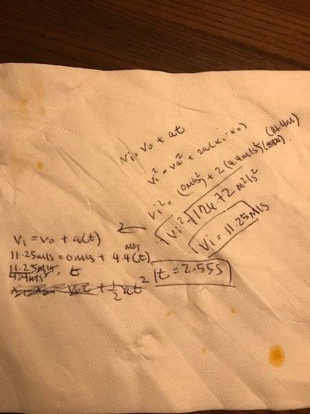

Again if we work in the frame of the truck, the problem is fairly simple. At time zero, the car and truck are moving at the same speed, so if you are in the truck looking at the car, at what speed does the car appear to be moving?

Well if they're both moving at the same speed, it would look like the car isn't moving. While the car's accelerating, then.. (currently out atm!)
Right so ##v_{0}=0## in the one dimensional motion equation
$$\Delta x =v_{0}+\frac{1}{2}at^{2}$$
You already know ##\Delta x## and ##a## so what is ##t##?

2.52s?
Did you set ##\Delta x=14.4##m?
Your answer is slightly off.
Whoops, divided by 14m instead. So the answer was t=2.55s? That's the same thing I got when I did it on the napkin.
Yes, but this was much faster!

Ok, that was using relative motion, i.e. the reference frame of the truck, and that is definitely the easier way. Just to see it can also be done in the ground frame:
Say at time 0 the car is immediately behind the truck and the rear of the car is position zero.
At time t the rear of the car is at the front of the truck. Writing that as an equation:
2.4+12+26t = 0+26t+½4.4t2.
The cancellation of the two 26t is equivalent to working in the truck's frame.
