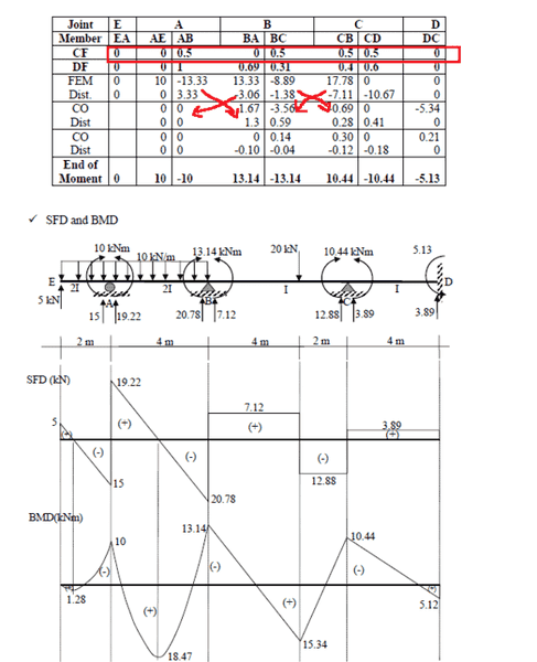

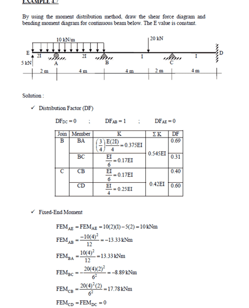

I have several question regrading with this post .
1.) For BC and CB , we could see that it's far end pinned / roller supported , so , shouldn't be the K = (3/4)(EI / L ) ?
2.) I don't understand how the carry over factor works (in the second picture)
1.) I think the K for BC and CB are wrong , it should be K = (3/4)(EI / L ) ,, because at BA, we could see that K = (3/4)(EI / L ) ... [/B]
2.) I don't understand for the carry over factor for BA is 0 ... We can see that for AB , BC and also CD , the carry over factor is 0.5 , so shoulnt the carry over factor for BA is 0.5 also ?
  • Continuous beam diagram with nodes E, A, B, C, D; 10 kN/m uniform load on the first span and a 20 kN point load at B; spans 2 m, 4 m, 4 m, 2 m, 4 m, with a 5 kN load at E.
  • Moment distribution table with columns for joints E, A, B, C, D and members EA, AE, AB, BA, BC, CB, CD, DC, showing stiffness factors, fixed end moments, distribution and carry-over rows, and end of moment values.
I'm going to guess that you are not getting much response here, at least in part, to the use of the term "carry over factor." This is a strange term to me, and I've been doing things like this for a very long time. Can you re-word you question to convey your meaning more clearly?
it's in the structural analysis syllabus ...It's carry over factor ,
The perhaps you can ask the person who drew up the syllabus what it means.
