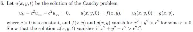

Could someone tell me where to start? I tried separating variables, which got me no where (plus we haven`t technically learned it), and I tried putting it into a form of D^2U, but I couldn`t figure that out either. Please help.

I think the question is saying that it is radially symmetric, do you agree?
Yes that`s what it seems like.
So what is the radially symmetric part of Laplace operator \nabla^{2}
In polar coordinates, it is (1/r)(d/dr)(rdu/dr)...Am I suppose to take the laplacian of u, and see something?
Expand that out and denote v=ru, and what equation do you have now?
But u(x,y,t) is not in terms of r, can I write u(r,t) instead and use the laplacian on that? If that`s what you mean..or do you mean something else?
I can expand it, and get (1/r)(du/dr)+(d/dr)(du/dr), but there is no u*r in this.
If I let u=v/r, I get v/r^3.
You should end up with the 1D equation for v, solve this in the usual manner and the problem is easily solved.
I get v/r^3 = 0 :S...I edited my post if you didn`t see, can you check if that`s what I`m suppose to get? (but I still don`t yet see how this will show that u vanishes for the given condition, or why we can assume u satisfies laplace`s equation).
Thanks for the help btw.
Just to confirm the equation you should be solving is:
<br /> \frac{\partial^{2}u}{\partial t^{2}}-c^{2}\left(\frac{\partial^{2}u}{\partial r^{2}}+\frac{2}{r}\frac{\partial u}{\partial r}\right) =0<br />
Use v(t,r)=ru(r,t) to obtain a 1D wave equation, turn that intop characteristic co-ordinates in the usual way and that will give you your solution.
I am off to bed now.
So do you mean I should I write u=v/r, and insert that into the equation you wrote? Good night, thanks.
If so, I get vtt=0, hope that is right!
Yes, have you not been doing that?
I wasn`t before :S, but now I get I get vtt=0, so I guess I can just integrate that and substitute u in.
as u=u(t,r) so is v=v(t,r)
I get u(r,t)=a(r)*r*t+r*b(r), where a,b are some functions of r. I don`t see how this means u vanished for the given condition though :S
Edit: Oops I didn`t differentiate the v.
Calculate:
<br /> \frac{\partial^{2}v}{\partial r^{2}}<br />
to get the folowing equation:
<br /> \frac{\partial^{2}v}{\partial t^{2}}-c^{2}\frac{\partial^{2}v}{\partial r^{2}}=0<br />
Then introduce the co-ordinates:
<br /> \begin{array}{ccc}<br /> \alpha &amp; = &amp; r+ct \\<br /> \beta &amp; = &amp; r-ct<br /> \end{array}<br />
use the condition you have and this should give you the result you need.
