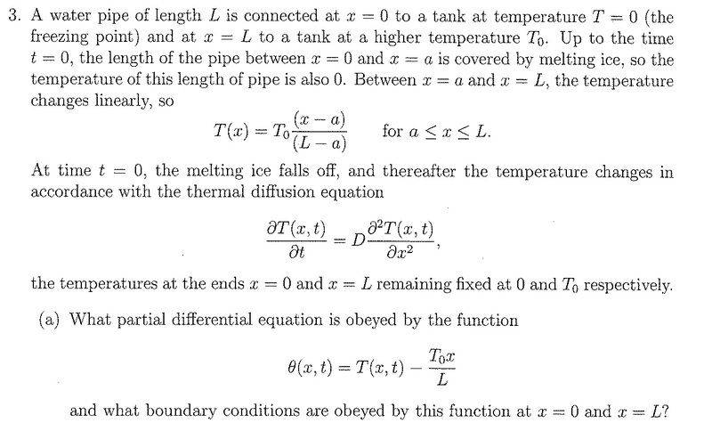

Part (a) below:
There's more to this question but I'm only stuck on this first part so far.
I have no idea what specific PDE the equation, θ(x,t) = T(x,t) - T0x/L , obeys
In this module (mathematics) we've covered the wave equation, diffusion equation and Schrödinger equation as examples of PDEs in physics. We've done separation of variables and are now onto using Fourier series to solve PDEs.
In answer to the question, am I supposed to say a straight-forward, "This PDE obeys the wave/diffusion/Schrödinger equation", or does it simply obey some general PDE that I need to figure out for myself? Either way, I can't really see what I'm looking for. Or at least I can't see anything of value which can then take me on to solving the rest of the problem. I presume it should somehow take me back around to the diffusion equation..?
Thanks

What happens if you calculate ##\Theta_{xx},~\Theta_{tt}## and compare with your thermal diffusion equation?
Or solve for T in terms of ##\Theta##.

I misread your original equation as having ##T_{tt}## in it, so I meant to suggest calculating ##\Theta_t##, not ##\Theta_{tt}##. So, as you noted, you do get ##\frac{\partial Θ}{\partial t} = D\frac{\partial^2 Θ}{\partial x^2}##. But the important point you are missing is that you haven't answered what boundary conditions ##\Theta(x,t)## satsfies. Your original function satisfies ##T(0,t)=0,~T(L,t)=T_0##.
So, I repeat, what boundary conditions does ##\Theta## satisfy? Is there any reason to prefer trying separation of variables on one or the other of the boundary value problem for ##T## or ##\Theta##?

Hmm, I think I'm beginning to get it. Because of the boundary conditions on ##T(x,t)##, it would mean the boundary conditions:
##Θ(0,t)=0##
and
##Θ(L,t)=0##.
are apparent.
Using separation of variables is presumably easier in solving for ##Θ(x,t)## because of the neater boundary conditions
But I don't understand how I'm supposed to prove that it obeys the diffusion equation in the first place - it seems to be something of a blind leap to take ##Θ_{xx}## and ##Θ_t##, separately, then just equate them with a scaling factor of D.
Just think of ##T(x,t) = Θ(x,t) + \frac{T_{0}x}{L}## as a change of variable in your initial problem. Substitute it in and you get a new BVP with homogeneous boundary conditions, which you can solve. With the ##T_0## on the one boundary condition, after you try separation of variables you will wind up with something like ##X(L)T_1(t)=T_0## which won't even get you to ##X(L)=0## and the eigenvalues.
The point is, after you solve the ##\Theta## problem, you just substitute back for the solution to the ##T## problem. This exercise teaches you how to handle non-homogeneous BC's.
[Edited for better explanation]

There's no assuming required here. You know that T satisfies the diffusion equation. Since the derivatives are the same, ##\Theta## satisfies it also.

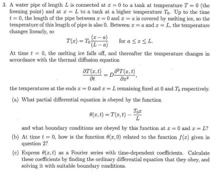

I think now also is a good time for me to reveal this problem in its entirety. It may help explain why I've jumped straight to the 'general solution' answer which had the Fourier series bunged in there.
For reference, the function f(x) in part b looks like:
## \sum_{n=1}^{\infty} \frac{2}{L}\bigg(\frac{L}{nπ}(1+\frac{a-L}{L-a})cos(\frac{nπa}{L})-(\frac{L}{nπ})^2(\frac{1}{a}+\frac{1}{L-a})sin(\frac{nπa}{L})\bigg) sin(\frac{nπk}{L})##
which only needs a bit of tweaking to make it represent the situation outlined for T(x) below.
In part c, I suppose I'm confused because it's telling me to express Θ(x,t) as a Fourier series with time-dependent coefficients. There's no mention of me needing to go through the process of solving the entire diffusion equation on its own. Maybe I took it too literally and should have thought 'out of the box' a bit more..? I suppose in hindsight it's fairly obvious since the diffusion equation is spelled out in the wording of the question, heh.
OK, let's recap and start over. You started with a pipe on ##[0,L]## whose temperature at ##t=0## is given as$$
T(x,0)=\left\{ \begin{array}{l,l}
0, & 0\le x \le a \\
T_0\left(\frac{x-a}{L-a}\right),& a\le x\le L
\end{array}\right.$$I will call that function ##F(x)##.
Now, at ##t=0## the ice is removed and the ends of the pipe are held at ##0## and ##T_0##, respectively. So you are given the diffusion boundary value problem (let's use k instead of D because D can be confused with differentiation):$$
T_t(x,t) = kT_{xx}(x,t) $$ $$
T(0,t)=0,~T(L,t)=T_0$$ $$
T(x,0) = F(x)$$Notice that one of the end point conditions is non-homogeneous.
Now you are asked to make the change of variable ##\Theta(x,t) = T(x,t) - \frac{T_0x} L##. I would like to see the steps showing how you got the answers for part (b).

Success, heh! Turned out the deadline was today at 12:00. Funny how a sudden panic can push things to happen.
I've identified the two parts that confused me.
First of all, I was under the impression that as ##t → ∞## the function ##T(x,t)## should tend to a flat average value since any real life thermal situation should generally involve a final equilibrium temperature which is uniform across the object. It then occurred to me that the given problem has fixed temperatures at each end, ##T(0,t) = 0## and ##T(L,t) = T_0##, so of course it won't result in some flat line. I was entering all sorts into Mathematica 'Manipulate' functions and watching it result in some line ##\frac{x}{L}## as I let ##t → ∞## . It suddenly occurred to me that this should be the case, heh, so I moved on to working out what the correct maths should be.
First I discovered this: http://tutorial.math.lamar.edu/Classes/DE/HeatEqnNonZero.aspx#ZEqnNum497179 , a page explaining the thermal diffusion equation for non-homogeneous conditions, which I stared at and looked over for a very long time before realising the very, very obvious thing I was missing : ##Θ(x,0)## is a Fourier series with coefficients defined by ##f(x)-\frac{T_0x}{L}##
So, for closure (and if you're interested), here's what I did.
Since ##Θ(x,t)## obeyed the diffusion equation, I used the solution
##Θ(x,t)=A_0 + \sum\limits_{n=1}^∞ A(t)sin(\frac{nπx}{L})##
which I plugged into the diffusion equation and solved for ##A(t)## to give
##Θ(x,t)=A_0 + \sum\limits_{n=1}^∞ A_ne^{-D(\frac{nπ}{L})^2t}sin(\frac{nπx}{L})##
Boundary conditions meant that ##A_0 = 0##
And, the real 'Eureka' moment...
When ##t=0## it was already shown that
##Θ(x,0) = f(x) + \frac{T_0x}{L}##
where ##f(x)## is the temperature distribution at ##t=0## and looked very similar to a previous problem in the assignment.
Now ##Θ(x,t)## had just been found as ##Θ(x,t) = \sum\limits_{n=1}^∞ A_ne^{-D(\frac{nπ}{L})^2t}sin(\frac{nπx}{L})##
which means
##\sum\limits_{n=1}^∞ A_ne^{-D(\frac{nπ}{L})^2t}sin(\frac{nπx}{L}) = f(x) + \frac{T_0x}{L}##
and this is nothing other than a basic Fourier series situation with coefficient:
##A_n = \int_0^L \! \Big(f(x) + \frac{T_0x}{L}\Big)sin(\frac{nπx}{L}) \, \mathrm{d}x##
##f(x)## is the temperature distribution at ##t=0## which is defined as:
##0## for ##0<x<a##
##T_0\frac{x-a}{L-a}## for ##a<x<L##
which mirrored a problem I had previously tackled with a relatively ugly solution so I shan't show it here.
Then all that needed to be done was the integral for ##A_n## which again looked ugly but consisted primarily of ##sin^2(x)## and ##x sin(x)## parts which are not too hard to manage, if not a little finicky with all those constants and variables bunged in.
The final answer then came to:
##T(x,t) = Θ(x,t) +\frac{T_0x}{L}##
##T(x,t) = \frac{T_0x}{L} + \sum\limits_{n=1}^∞ \Bigg[\Bigg(\frac{2}{L}\bigg(\frac{-L}{nπ}cos(nπ) - (\frac{L}{nπ})^2\frac{1}{L-a}sin(\frac{nπa}{L})\bigg) + \frac{2}{nπ}cos(nπ)\Bigg)sin(\frac{nπx}{L})e^{-D(\frac{nπ}{L})^2t}\Bigg]##
There may be typos along the way here but overall the main solution was one that shows the distribution described above for ##t=0## which tends to a straight line of the form ##\frac{T_0x}{L}## as ##t → ∞##
For the ultimate check, the following Mathematica code will give a manipulable plot to demonstrate it:
An = 2/L (-L/(n Pi) Cos[n Pi] - (L/(n Pi))^2 1/(L - a) Sin[n Pi a/L]);
Bn = AAAn + 2/(n Pi) Cos[n Pi];
a = 1; L = 5;
Manipulate[Plot[x/L + \!\(
\*UnderoverscriptBox[\(\[Sum]\), \(n = 1\), \(20\)]\(Bn\ Sin[n\ Pi\
\*FractionBox[\(x\), \(L\)]]
\*SuperscriptBox[\(E\), \(\(-
\*SuperscriptBox[\((n\
\*FractionBox[\(Pi\), \(L\)])\), \(2\)]\) t\)]\)\), {x, 0, 5}], {t, 0,
5}]
I just hope I didn't go disastrously wrong with my logic here... :oldcry::oldgrumpy::headbang::oldruck:
OK, that's good. It looks like you figured it out. I didn't check every little detail but it looks right. You could simplify the Fourier coefficients by noting that ##\cos(n\pi) = (-1)^n##. If you don't mind I am going to mark this thread as solved and call it a day.
Ah yeah, I was aware of the ##(-1)^n## thing but didn't 'notice' it until the majority of my working was in the form of ##cos(n\pi)##. Time was very much against me so it stayed as it was.
Thanks for the help with this, very much appreciated. Looks like it wasn't unsalvageable after all!
Sure, mark it as solved.
:oldsmile:
