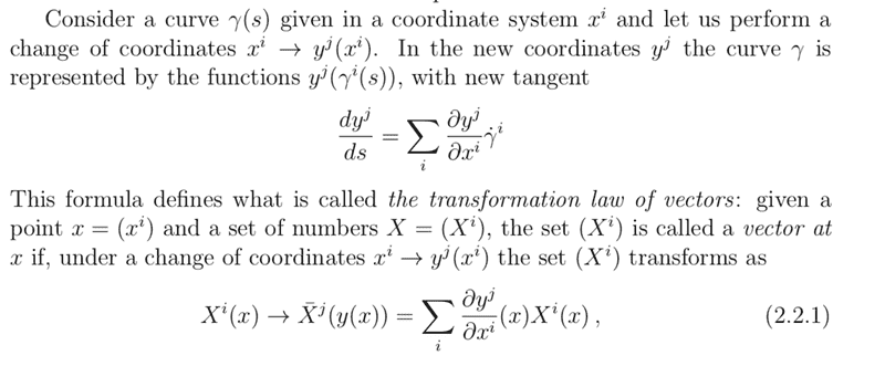

Orodruin said:
This is not correct unless ##x'## is a linear function of ##x##.
Are you sure? I see no assumption that the transformation need be linear in the derivation of this transformation.
smoking-frog said:
Are you sure?
I only wrote a textbook with a chapter on the subject. I am pretty sure. :rolleyes:
What you attached is the transformation rule for vector components. The coordinates are not components of a vector.
Edit: As a counter example, consider the one-dimensional manifold ##\mathbb R## with coordinates ##x## and ##y = x^3##. Then
y = x^3 \neq \frac{dy}{dx} x = 3x^3.
Those are just the coefficients, though, aren't they? ##\big( x^i \partial_i = x'^j \partial'_j \big)## does not imply ##x^i=x'^i##.
I literally took your transformation law and showed you that, in the simplest case, it would mean that 3=1. You don't have a problem with that?
Also consider the case of polar coordinates in two-dimensional Euclidean space. It is not true that ##x\partial_x + y\partial_y = r \partial_r + \theta \partial_\theta##, which would be the case if the coordinates were actually the components of a vector. For any coordinate system, there exists a vector field that has this property, but those vector fields will generally not be the same vector fields. Indeed, it is true that ##x\partial_x + y\partial_y = r \partial_r##. This has the form ##x^i\partial_i## in Cartesian coordinates, but certainly not in polar coordinates.
