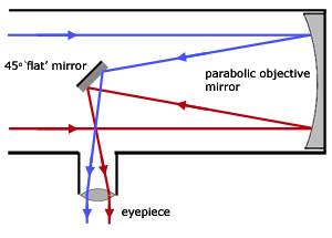

I don't think the parabolic antenna is a solution to what you are asking about. It sounds like you are wanting a way to aim fairly collimated lasers between several satellites and having good TX/RX gain between them. Parabolic antennas are not for receiving off-axis signals.
I think you will need to use a TX/RX pair for each communication path if they are not coaxial with the other paths. There may be a way to receive laser signals from multiple directions at once, but the signal-to-noise ratio will be pretty bad if you are receiving light from all around, just in order to be able to receive signals from a few discrete directions.

The question is what kind of Rx can you set up to receive the laser transmission. it would be incredibly difficult to center this light on a Rx
To have good optical receive gain, you use something that looks like telescope optics. Those optics can either be made up of lenses or parabolic mirrors, or a combination. But telescope optics have a very finite entrance pupil, and do not receive optical signals that are off-axis. So as long as the Tx laser beam source is enough on-axis to be received by the Rx optics, you get a good Rx signal. But if your Tx beam is way off axis (even a few degrees, depending on your optical gain), you will not see that beam.
http://www.a-levelphysicstutor.com/images/optics/tels-Newtonian.jpg
