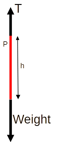

@NTesla, maybe this is one source of your difficulty...
NTesla said:
Now, in the ##\hat{i}## direction, the force is due to the weight of the hanging part of the chain,
That's not entirely correct. The horizontal section of the chain is accelerated by tension,T, acting at its right-most end:
We have to treat the falling vertical chain section as if there are only two forces acting on it*. The forces are its weight, ##\lambda h g## downwards and ##T## acting upwards at its top end:
The acceleration, ##a##, is the same for both sections, so you can (using N2L) construct 2 equations and eliminate T. This gives an equation relating ##x## and ##a##.
Hint: When you get this equation that remember ##a = v \frac {dv}{dx}##.
*The absence of a force from the ground, which affects the motion of the vertical section of the chain, has been discussed by @jbriggs444 and @haruspex.

NTesla said:
But there's another problem that I've mentioned in post#22, that is the cause of much problem.
Please show the details of your differentiation of the horizontal momentum. Looks like you missed a term.

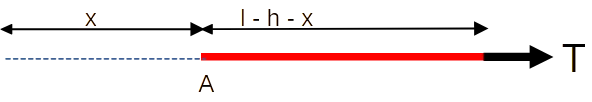

Here's all the steps:
## \Delta\vec{P} = \vec{P_{f}} - \vec{P_{i}}##
##\vec{P_{i}} = \lambda (l - x - h)v\hat{i} - \lambda hv\hat{j}##
##\vec{P_{f}} = \lambda (l - (x + \Delta{x}) - h)(v + \Delta{v}) \hat{i} - \lambda h(v + \Delta{v}) \hat{j}##
In the ##\hat{i}## direction: ##\Delta P\hat{i} = \lambda(l - (x + \Delta x) - h)(v + \Delta v)\hat i - \lambda (l - x - h)v\hat i##
= ##\lambda((l - x - h)\Delta v - \Delta x v)\hat i## (ignoring ##\Delta x \Delta v##).
Dividing both sides by ##\Delta t##, we get:
##\frac{\Delta P}{\Delta t} = \lambda((l - x - h)\frac{\Delta v}{\Delta t} - \frac{\Delta x}{\Delta t} v)##
Now, in the limit, ##\Delta t\rightarrow 0 ## the equation becomes:
in the ##\hat i## direction: $$\frac {dP}{dt} = \lambda((l - x - h)\frac {dv}{dt} - \frac {dx}{dt}v)$$
##\Rightarrow## For the horizontal part of the chain: ## \frac {dP}{dt} = \lambda((l - x - h)\frac{dv}{dt} - v^{2})##
Now, by comparing the force applicable on the horizontal and vertical part of the chains, for same acceleration throughout, we get: Force applicable on the horizontal part of the chain, ##F_{ext}## = ##\lambda h(g - \frac{\mathrm{d} v}{\mathrm{d} t})##.
##\therefore## ## \frac {dP}{dt} = \lambda((l - x - h)\frac{dv}{dt} - v^{2})## = ##\lambda h(g - \frac{\mathrm{d} v}{\mathrm{d} t})##.
But, this is not the right differential equation which leads to the correct answer. As I had mentioned in post#22, for reaching the correct differential equation, the ##v^{2}## term needs to vanish. For that to happen the term ##( - \Delta x v\hat i)## terms needs to vanish. That can only happen if there's an additional term ##+ \Delta x v\hat i## in the expression for ##\vec {P_{f}}##. However, I do not see how or why there could be an additional term ##( + \Delta x v\hat i)## in the expression for ##\vec {P_{f}}##. This is where I'm facing the problem.

Ok, I understand now. You have fallen into the classic trap of applying ##F=\frac{d(mv)}{dt}=v\frac{dm}{dt}+m\frac{dv}{dt}## to a variable mass system.
Consider a cart rolling on a level surface and leaking water. If we apply that equation to the cart plus contents we conclude that the cart will accelerate! The error is that the first part of that equation only applies in a closed system, but in closed systems m does not vary.

Right, but that's rocket+fuel+exhaust, which is a closed system.
There are two issues here.
First, somehow an element leaves the horizontal segment to become part of the vertical segment, which must involve forces that do not appear in your equation. Now, there’s probably an argument that gets around that because the tension must be the same both sides of the bend.
More seriously, you have overlooked the "exhaust" consisting of the element has hit the table. To include that, you must add in the normal force from the table that brings that element to rest.

But that element is the "exhaust". The loss of it is removing momentum from the system. It is the water leaking from the cart.

haruspex said:
Well, obviously, the usual steps of cancelling out the non-infinitesimal terms and discarding the second order infinitesimals. What does that give you?
Did you really thought that you were being helpful when you wrote that ?
When I wrote the last equation in post#52, it was obvious to me that even if I cancelled the 2nd order differentials and cancelled out the non-infinitesimals, the situation hasn't improved at all, in the direction of solving the question. But apparently, it wasn't obvious to you. I suppose it would have been obvious to you too, had you bothered to read the equation, instead of just glancing at the post. Atleast @jbriggs444 made that effort and came up with some reasoning why the last equation in post #52 wouldn't work, and I appreciate him for that.
In an attempt to make the situation plain and simple to understand, and to take the discussion forward, I'll write down the equation after having cancelled out the non-infinitesimal terms and discarding the second order infinitesimals.:
In the ##\hat i## direction, we have: ##l\Delta v - x\Delta v - \Delta x v - h\Delta v = 0##
and in the ##\hat j## direction, we have: ##h\Delta v -\Delta x v = hg - \frac {\Delta x}{\Delta t}v ##
From these 2 equations, we have: ##l\Delta v -x\Delta v = hg - \frac {\Delta x}{\Delta t}v + 2 \Delta x v##
Any idea of what to do next after the above equations ? Or are you going to say "Ok, I'll give you that one" and then abandon the whole thing, again ?

I would argue that instead of a tube, if the chain was kept on a table, and everything else remained the same, even then the chain would bend and move down at the edge of the table. I don't see how mouth of the tube has anything to do with why the chain would go down.
The drawing shows the chain descending vertically. Not in some sort of [evolving!] parabola. This implies that the chain is constrained not just by the bottom of the tube but also by its top and right where the tube turns downward at its mouth.
If the chain fell in a curve then the length of the falling portion would not be ##h##.
  • #60
Yes, that makes sense.
So, the rightmost part of the mouth of the tube would exert a leftward force on the piece of the chain which is right at the bend, and the magnitude of that force would be exactly equal to cancel the horizontal momentum carried by that piece. So, that piece would only have downward momentum from that point on.
