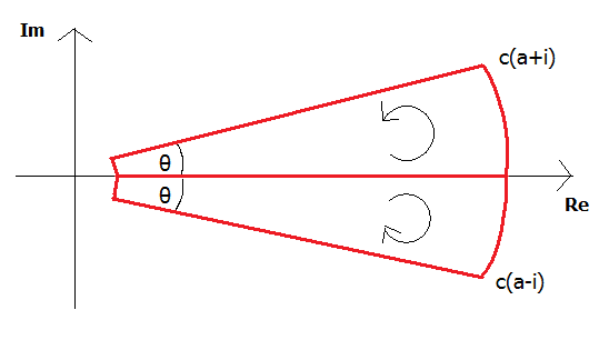

First, let the lower integration border be ##\epsilon>0## and interpret the integral as limit of ##\epsilon \to 0## later.
Then
$$\int_{\epsilon}^{\infty} e^{-ax} \frac{\sin(x)}{x} dx
= \frac{1}{2i} \int_{\epsilon}^{\infty} e^{-ax} \frac{e^{ix}-e^{-ix}}{x} dx
= \frac{1}{2i} \left( \int_{\epsilon}^{\infty} \frac{1}{x}e^{-ax+ix} dx\; +\; \int_{\epsilon}^{\infty} \frac{1}{x}e^{-ax-ix} dx \right)$$
Consider the first integral:
$$\int_{\epsilon}^{\infty} \frac{1}{x}e^{-ax+ix} dx$$
This can be seen as integral in the complex numbers. The integrand has a pole at x=0 and nowhere else.
Define:
##\displaystyle \theta=arctan(1/a)## (this is nice!) and ##A=|a+i|=\sqrt{a^2+1}##
We can use the upper red loop in the sketch to evaluate it. As the size of the loop goes to infinity, the contribution from the large curved section goes to zero (due to e-ax).
Let ##x=\frac{a+i}{A}r##. Then we can write the contribution from the inclined section as real integral:
$$\int_\epsilon^{\infty} \frac{A}{(a+i)r}e^{-Ar} dr = \frac{A}{a+i} \int_{\epsilon A}^{\infty} \frac{e^{-r}}{r} dr$$
We cannot take the limit ##\epsilon \to 0## at this point, and we cannot evaluate it either, so we just leave it. We have to count this negatively in the loop.
What about the small curved section? This is the classic integral over f(z)/z, the result is ##\theta f(0)## plus some expression that will vanish in the limit ##\epsilon \to 0## afterwards. Here, f(0)=e0=1, so the result is just ##\theta##. Again, we have to count this negatively.Consider the second integral:
$$\int_{\epsilon}^{\infty} \frac{1}{x}e^{-ax-ix} dx$$
Follow the same procedure, just with ##x=\frac{a-i}{A}r##. The integral becomes
$$\int_\epsilon^{\infty} \frac{A}{(a-i)r}e^{-Ar} dr = \frac{A}{(a-i)} \int_{\epsilon A}^{\infty} \frac{e^{-r}}{r} dr$$
The small curved section gives ##\theta## again, this time with a positive sign, so the contributions cancel.
Our total integral is now 1/(2i) times the sum of the two real integrals obtained above:
$$ \frac{1}{2i} A \frac{(a-1)+(a+1)}{A^2} \int_{\epsilon A}^{\infty} \frac{e^{-r}}{r} dr
= -i \frac{a}{A} \int_{\epsilon A}^{\infty} \frac{e^{-r}}{r} dr$$
And here the problem is visible. This integral does not converge for ##\epsilon \to 0## (and the result is purely imaginary, literally and figuratively.).

Yeah, that's what I need Boorglar: rigor to justify taking the derivative that way. Thanks.
Also mfb, spotted some mistakes:
(1) The first integral expression should be:
= \frac{1}{2i} \left( \int_{\epsilon}^{\infty} \frac{1}{x}e^{-ax+ix} dx\; -\; \int_{\epsilon}^{\infty} \frac{1}{x}e^{-ax-ix} dx \right)$$
(2) An integral over an indentation around a simple pole at the origin for [itex]f(z)/z[/itex] (as radius goes to zero) is [itex]\theta i f(0)[/itex]. You forgot the i.
Did it quick but looks like it ends up being:
[tex]\frac{1}{2 i} \left(i\arctan(1/a)+\int_0^{\infty} f(r)dr+i\arctan(1/a)-\int_0^{\infty}f(r) dr\right)[/tex]
which then gives us the requisite [itex]\arctan(1/a).[/itex]
Oh, that sign was a stupid mistake.
I forgot the i, but as the contributions canceled (due to the sign error, crap) I did not check that again.
I'm not sure if the prefactors work out properly, if I just change the sign I don't get matching prefactors for the two integrals.
Ok, just to check it, I'll just let [itex]z=re^{i\theta}[/itex] on the top path and [itex]z=re^{-i\theta}[/itex] on the bottom path with [itex]\theta=\arctan(1/a)[/itex]
For the top, I get:
[tex]\int_0^{\infty} \frac{e^{x(i-a)}}{x} dx=i\theta+\int_0^{\infty} \frac{e^{re^{i\theta}(i-a)}}{r}dr[/tex]
and the bottom:
[tex]\int_0^{\infty} \frac{e^{-x(i+a)}}{x} dx=-i\theta+\int_0^{\infty} \frac{e^{-re^{-i\theta}(i+a)}}{r}dr[/tex]
so that when we add everything up, we get the factor
[tex]\int_0^{\infty} \frac{e^{re^{i\theta}(i-a)}}{r}dr-\int_0^{\infty} \frac{e^{-re^{-i\theta}(i+a)}}{r}dr[/tex]
and
[tex]e^{r e^{i\theta(i-a)}}-e^{-r e^{-i\theta(a+i)}}=0[/tex]
for [itex]\theta=\arctan(1/a)[/itex].
Okay. Good to see that the "direct" approach is possible.
I probably should have written that as:
[tex]\frac{1}{2 i} \left(i\arctan(1/a)+\int_0^{\infty} f(r,\theta)dr+i\arctan(1/a)-\int_0^{\infty}g(r,\theta) dr\right)[/tex]
and [itex]f(r,\theta)-g(r,\theta)=0[/itex] for [itex]\theta=\arctan(1/a)[/itex].
