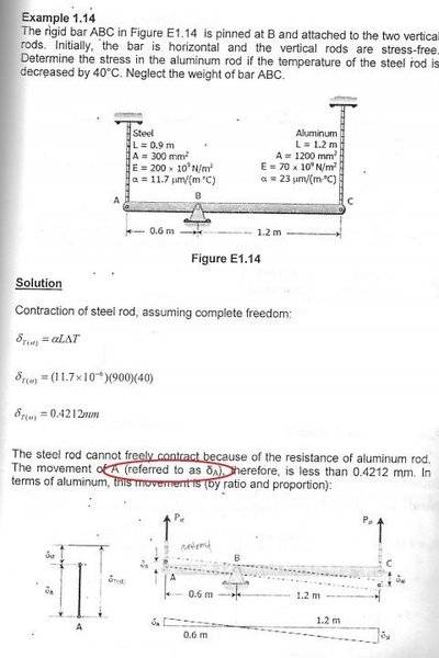

in the notes , i was told that ∂A is the resistance of aluminium rod...I'm wondering the change length of steel rod that we can 'see' is ∂ st or ∂T(st) ?
I think the change length of steel rod that we can 'see' is ∂ st ?
  • Textbook figure E1.14: rigid bar ABC pinned at B, hung from steel rod (L = 0.9 m) on the left and aluminum rod (L = 1.2 m) on the right, with the solution's contraction calculations and a proportional-movement diagram below.
This time they use ##\delta##, not ##\partial## :smile: .
It clearly says 'the movement of A'
Has nothing to do with the resistance ??
I don't see ##\delta A##, only ##\delta_A##.
And under 'contraction of steel rod' I can't distinguish what it says, something like ##\delta_{T(st)}## ?

I think the δT(st) is contraction of steel rod due to drop in temperature...
So, when we want to measure the change in length, the length that we gt is δA or) δT(st)?
P/s : the diagram beside the figure of rod is δ(st) + δT(st) = δT(st)
It's the contraction that would have occurred due to temperature if the aluminium rod were not there.
δA is the observed contraction in the steel. δst is the discrepancy between the two.
But I do not understand what the diagram shows at C. It's a bit fuzzy, but it looks like it says the expansion of the aluminium rod equals the observed contraction of the steel rod. That is clearly not the case.

so, δA is the observed contraction in the steel?
What is δT(st), we wouldn't see it with naked eyes?
The stress in the steel rod is given by: $$\sigma_s=E_s(\epsilon_s-\alpha_s \Delta T)\tag{key}$$
where ##\epsilon_s## is the strain in the steel rod, Es is the Young's modulus of the steel rod, and ##\alpha_s## is the coefficient of linear expansion of the steel rod. This equation says that, if the steel rod expands with no constraint (i.e., with ##\sigma_s = 0##), the strain in the rod is ##\epsilon_s = \alpha_s \Delta T##, but, if the stress in the rod is greater than 0, the strain will be greater than ##\alpha_s \Delta T##. If ##\delta_s## is the downward displacement of the end of the steel rod, then ##\epsilon_s=\delta_s/L_s##, and $$\sigma_s=E_s\left(\frac{\delta_s}{L_s}-\alpha_s \Delta T\right)$$
Geometrically, the downward displacement of the end of the steel rod is related to the downward displacement of the end of the aluminum rod by:$$\frac{\delta_s}{0.6}=-\frac{\delta_A}{1.2}\tag{1}$$
The tensile stress in the aluminum rod is given by$$\sigma_A=E_A\frac{\delta _A}{L_A}$$
The tension in the steel rod is given by$$P_s=A_s\sigma_s=A_sE_s\left(\frac{\delta_s}{L_s}-\alpha_s \Delta T\right)\tag{2}$$
Similarly, the tension in the aluminum rod is given by $$P_A=A_AE_A\frac{\delta _A}{L_A}\tag{3}$$
If we combine Eqns. 1-3 with the moment balance on the bar ABC, we can solve for all the displacements, strains, stresses, and tensions. What is the moment balance on the bar ABC in terms of the tensions ##P_s## and ##P_A##?
The key to this whole analysis is the equation labeled "key." This equation takes into account the thermal expansion strain experienced by the rod plus whatever extra strain experienced by the rod to give the overall stress.
No, you would not, but you can calculate it from the temperature change.

δA is the observed contraction in the steel? the change in length that we can notice is δA ? then , what does δ(st) means ?
As I posted, it is the difference between δA and δT(st). What is the immediate cause of that difference?

How does the aluminium rod affect the contraction of the steel rod?
When steel contract, aluminum extend...
Yes, but think about the forces. What is the consequence for the steel?
The steel contract, the forces act upwards?
The contraction of the steel is because of the temperature change. How is this altered by the aluminium rod? Is the steel under compression or under tension?
chetzread said:
the sigma s is strain , which is the change in length / original length , right , why you said it is constraint ?
No. As I said, it is the stress (not the strain).

Forget about A. We're just focusing on the steel. Even though the steel rod is shorter than its original length (because of its decrease in temperature), it is still in tension because it is not being allowed to contract in length as much as it would have liked to. So the original equation I gave is correct, and captures both the effect of the decreased temperature and the constraint of not being able to contract (as much). We are using the sign convention that tensile stress is positive.

since there's constraint, so $$\sigma_s >0$$ ?
if so, εs > αΔT ?
But, that's not the case...In the notes in the post#1, (st) > A , which means αΔT> εs , Am i right?

The steel contracts because it is cold. That is not compression. Compression would be contraction because of an externally applied force.
What force is being externally applied?

No. ##\alpha \Delta T## is negative, so ##-\alpha \Delta T## is positive and, even if ##\epsilon_s## is negative, the stress is still positive.
Here is a thought experiment for you. You take a rod of steel and cool it (without constraining it) so that it contracts to a new length. The stress in the rod after cooling is still zero, but it has experienced a negative strain. Now you stretch the rod at constant temperature back to nearly (but not quite) its original length. Is it now under tension or compression?

do you mean in $$\sigma_s=E_s(\epsilon_s-\alpha_s \Delta T)\tag{key}$$
, εs is negative(due to contraction) , and -σsΔT has positive value (-σs(-T) =positive) , so σs has positive value?
tension
