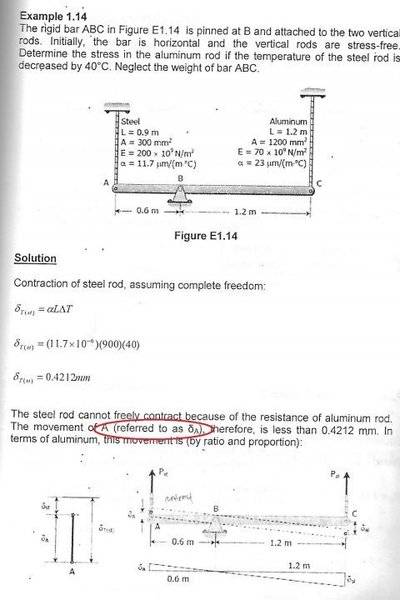

chetzread said:
I understood the cooling part, I'm confused about the heating part, which part of my idea is incorrect for the heating part in post#88 ?
Heating should be even easier to analyze than cooling. If you heat it, and you allow it to expand unconstrained (no stress), the strain must be positive and equal to ##\alpha \Delta T##. If you constrain it such that the strain is ##0<\epsilon<\alpha \Delta t##, the strain will still be positive, but the rod will be under compression, and the stress will be negative. If apply a strain over and above the amount that it would stretch unconstrained, ##\epsilon>\alpha \Delta T##, the rod will be under tension, and the stress will be positive. All this is contained in the equation we have been working with if you are sufficiently disciplined mathematically to work with the signs correctly.

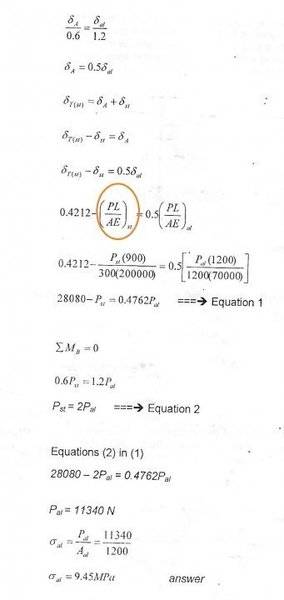

Chestermiller said:
The stress in the steel rod is given by: $$\sigma_s=E_s(\epsilon_s-\alpha_s \Delta T)\tag{key}$$
where ##\epsilon_s## is the strain in the steel rod, Es is the Young's modulus of the steel rod, and ##\alpha_s## is the coefficient of linear expansion of the steel rod. This equation says that, if the steel rod expands with no constraint (i.e., with ##\sigma_s = 0##), the strain in the rod is ##\epsilon_s = \alpha_s \Delta T##, but, if the stress in the rod is greater than 0, the strain will be greater than ##\alpha_s \Delta T##. If ##\delta_s## is the downward displacement of the end of the steel rod, then ##\epsilon_s=\delta_s/L_s##, and $$\sigma_s=E_s\left(\frac{\delta_s}{L_s}-\alpha_s \Delta T\right)$$
Geometrically, the downward displacement of the end of the steel rod is related to the downward displacement of the end of the aluminum rod by:$$\frac{\delta_s}{0.6}=-\frac{\delta_A}{1.2}\tag{1}$$
The tensile stress in the aluminum rod is given by$$\sigma_A=E_A\frac{\delta _A}{L_A}$$
The tension in the steel rod is given by$$P_s=A_s\sigma_s=A_sE_s\left(\frac{\delta_s}{L_s}-\alpha_s \Delta T\right)\tag{2}$$
Similarly, the tension in the aluminum rod is given by $$P_A=A_AE_A\frac{\delta _A}{L_A}\tag{3}$$
If we combine Eqns. 1-3 with the moment balance on the bar ABC, we can solve for all the displacements, strains, stresses, and tensions. What is the moment balance on the bar ABC in terms of the tensions ##P_s## and ##P_A##?
The key to this whole analysis is the equation labeled "key." This equation takes into account the thermal expansion strain experienced by the rod plus whatever extra strain experienced by the rod to give the overall stress.

If we have a rod to which we apply a temperature change while at the same time partially constraining it, we can model this as a two step process.
Step 1. Apply the temperature change to the rod without constraining it
Step 2. Apply a stress ##\sigma## to the rod to arrive at the final constrained length
Let ##\epsilon_1## represent the strain of the rod in Step 1 and let ##\epsilon_2## represent the strain in Step 2. Then:
$$\epsilon_1=\alpha \Delta T$$
$$\epsilon_2=\frac{\sigma}{E}$$
The total strain for the combined process is the sum of the strains for each of the two steps:
$$\epsilon=\epsilon_1+\epsilon_2=\alpha \Delta T+\frac{\sigma}{E}$$
What do you get if you solve this equation for ##\sigma## as a function of ##\alpha \Delta T## and ##\epsilon##?
total strain = 0 , which means
i could write it as σs = -E α(T) , so ?
So, the equation I derived applies to all values of the total strain, and not just to total strain = 0.

haruspex said:
It's the contraction that would have occurred due to temperature if the aluminium rod were not there.
δA is the observed contraction in the steel. δst is the discrepancy between the two.
But I do not understand what the diagram shows at C. It's a bit fuzzy, but it looks like it says the expansion of the aluminium rod equals the observed contraction of the steel rod. That is clearly not the case.
here's the full notes , δst is caused by force Pst( in upward) ?
if it' so , we will be able to 'see' the δst , am i right ?
It is caused by the force and the temperature change. The force on the rod is in the upward direction at the top of the rod and in the downward direction at the bottom of the rod. The force on the lever is in the upward direction at the connection with the steel rod.
δst is defined as the displacement that you see.
As I read it, ##\delta_A## is the observed displacement. ##\delta_{st}## is the difference between that and the displacement that would have occurred if not attachd to the crossbeam.

haruspex said:
δst
What causes ∂st ?
It's the force Pst , right ?
chetzread said:
What causes ∂st ?
Yes.

haruspex said:
Yes.
so , the Pst point downwards at the point A , causing the steel rod can't contract by del (Tst) , but only contract by del (A) ?
Yes.

haruspex said:
Yes.
sorry , i made a typo in my previous post ...
Just to verify my concept , do you mean the Pst cause the rigid bar ABC to move downwrads at A , so the contraction that we could observe is ∂A ( ∂(Tst) - ∂st = ∂A ) ?
This is due the original contraction with no aluminium rod constraint is ∂(Tst) ( cause end of bar ABC to go up at A ) , but the Pst cause the steel rod to move downwards at A , so the contraction that we could observe is ∂A ( ∂(Tst) - ∂st = ∂A ) only ?

I find this a bit hard to answer because I cannot read the subscripts on the two P forces shown in the diagram at post #1. I assume Pst is the left hand one, and represents (in the diagram) the force exerted at the top of the steel rod by a restraint. Correspondingly, the bar at the bottom will exert an equal and opposite force. So yes, that downward force on the steel rod at A is what will reduce the contraction from ∂(Tst) to ∂A. But it is not quite right to say that Pst causes this. It is the pair of equal and opposite forces putting the rod under tension that causes it.
if so , then the downward and upwards direction forec will cancel out each other , right ? How to reduce the contraction from ∂(Tst) to ∂A ?
Pst is actually caused by the aluminium rod ?
They cancel out in the sense that there is no net force on the rod (otherwise, the rod would accelerate) but the combination produces a tension in the rod, thereby stretching it.
That is the ultimate cause, but the connection to the bar at one end and to some restraint at the other end is the proximate cause.

Chestermiller said:
Step 2. Apply a stress σσ\sigma to the rod to arrive at the final constrained length
do u mean apply it to the opposite direction of the ϵ1=αΔT ?
Yes
