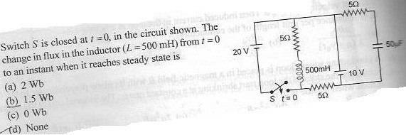

arnab321
afaik, flux in inductor = Li.
at t=0, current through L is 0. so change of flux = LΔi = L(i-0)=Li
at t=∞, i through cap. is 0.
so,
i get the following equations:
5(i1+i2)=20
5(i1+i2)+ 5i2=10
i get i2=-2 and i1 = 6
i through indctor = i1+i2 = 4
so, flux=Li= 0.5*4=2
book's ans. is different.

t-o current is zero in the inductor lol
but capacitor was charged at t-0
You did everything right except for assuming the current through the inductor is 0 right before the switch is closed.
Well, um... Current through inductor is i=i0(1-e^(-t/tau)). Putting t=0 in the equation, I get i=0.
That equation only applies to a simple LR circuit with the initial condition i(0-)=0. That's not what you have here.
edit: oh I'm sorry I didn't see the battery there before the switch is closed.
I got the ans. 1.5.
That's not entirely accurate. At steady state, a capacitor acts like an open circuit, and an inductor, like a short circuit. I wouldn't say, however, the opposite is true at the beginning of a transient.
So suppose the switch has been open a long time before t=0. You replace the inductor with a short. What's the current flowing through the upper-left resistor? That will be the initial current through the inductor.
