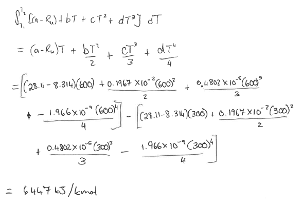

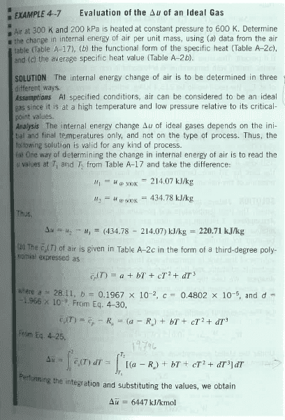

Δu = ∫ [(a-Ru)+bT+cT^2+dT^3]dT
The answer of 6447kJ/kmol is given but I am struggling to get to this answer after integrating the above formula and inserting the given values.
Firstly would the integral of [(a-Ru)+bT+cT^2+dT^3]dT
be:
[(a-Ru)+bT^2/2+cT^3/3+dT^4/4] ?
No. The first term should be (a-Ru)T.
Is this because (a-Ru) is a constant?
eg. ∫1 dx = x
Yes
mjc123 said:
Yes
Thank you let me give that a try.
