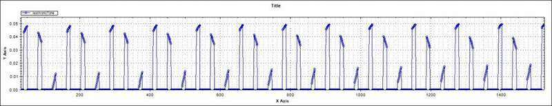

and this is how it looks on a graph :

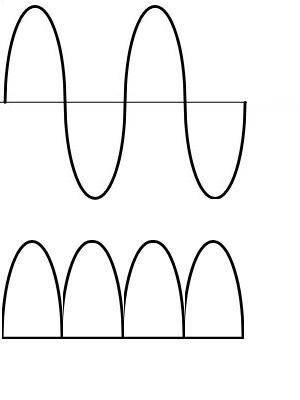

Picture of sine wave vs absolute value of sine wave. Not completely sure if there will be much difference in the sound of the audio, but if I were you I would take out the absolute value just to give it a try.

... what were you expecting it to look like?
note: for a graph to make sense, you have to say what the axes represent.

The graph you get looks like it wants to be a sine wave but there are bits missing from it.
Your program has a condition where you are setting the value to zero.
Re-examine those conditions.
But you have to tell us what the program has to do before we can help you properly.

I suspect the program is setting large blocks of zeros which is giving a chopped sine wave.
The remaining bits could act like two or three superimposed signals (2 bars and a triangle).

Now that I’ve thought about this a bit more, I have decided that although the absolute value sine wave might sound ok if we could hear it exactly like that, there is no way to reproduce that in the real world. In the real world there is hysteresis in the speaker coil, and momentum in the speaker head, etc, and you will not be able have the signal switch from a straight downward slope to a straight upward slope instantaneously.
Do take out the absolute value function, and smooth the signal edges at ramp up and ramp down, then see if you still have any more problems.

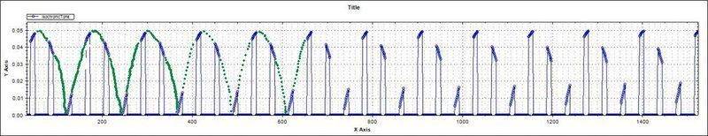

The low frequency, that should not be there. if you listen to the file, it comes and go... and it get louder and lower, like a sinwave
@ simon
"What is the program supposed to do though?!"
is supposed to play a tone at on a beat.. but it should not have the low frequency in it

The wave form you had on your graph looks like most of a half-wave with chunks missing - and repeated.
Now what do you need the graph of the wave to look like?

OK, I found out what is going on. Your pulses are way too short in relation to the main frequency that you are modulating. I have filled in the absolute valued sine wave from the graphic that you provided in green to give you an idea.
Do you need help with the math? Assuming (based on your code) that is your playback sample rate is 44100, and your playback frequency is 1000 hz, then you should find 1000 complete sine wave cycles for each second, or one sine wave every 44.1 samples. If you pulse that once per second you should get 500 complete cycles within each pulse.
Yes I need help with the math.
also I just learned that my wave is all wrong. I have an program that picks up sound wave and does an FFT. I know that program works because I tested it with this site
http://onlinetonegenerator.com/?freq=5000
but when I play my tone generator the Freg are a little over 2 time what it should be.. why?
here is my code
