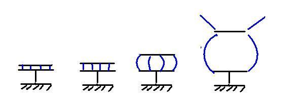

The voltage increases between the capacitor plates with distance d till the distance is still much less then the size of the plates. Only in that case is approximately true that the electric field E is homogeneous and thus V=Ed.
See picture. One plate is grounded, the other having positive charge, is moved away from it. The edge effect appears and the field lines scatter out more and more from between the plates as the distance increases. At very high distance the plate behaves more and more as a point charge.
ehild
This is quite true but it doesn't give a clean break where we can declare "The Capacitor is no longer operating". In my experience you'll get parasitic capacitors dominating long before you reach a situation where the plates behave as point charges.
Even a single charged piece of metal operates as a capacitor, as it has some voltage with respect to the ground, or infinity, and C=Q/U. Only the capacitance is no more C=εA/d when d is comparable to the size of the plates.
