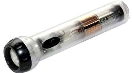

A non-mathematical approach to the qualitative question was suggested by @eq1 in post #5. Those shake-to-light flashlights are analogous to your idea. That is a voltage and power level in the same order of magnitude as charging a battery. Look at the magnets and wires, and the battery, inside those flashlights, consider the vigor needed to shake them, and consider how quickly the LED goes out when you stop shaking (about 1 minute shaking gives 10 seconds light), then imagine how many hours it might take to completely charge the battery, and you have a guess at your answer.
Transparent shake-powered flashlight with a black LED head, a visible coil of copper wire around an internal magnet, and the printed words 'ULTRA BRIGHT LED' on the tube.
  • Transparent shake-powered flashlight with a black LED head, a visible coil of copper wire around an internal magnet, and the printed words 'ULTRA BRIGHT LED' on the tube.

If you conceal an array of flat coils behind the panel, each with its own rectifier, then waving a powerful magnet in front will generate a small amount of power. Analogy is a wind-up torch, where you crank a tiny motor as a generator. Efficiency would be very, very low, of course.
I have one of those flashlights. One minute of shaking charges the capacitor, not battery, enough to give a couple seconds of useful light then many minutes of glow that is not particularly useful.
