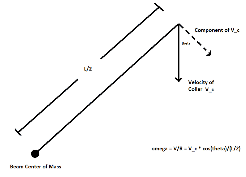

Now I am confused, haruspex. I used this picture to find the expression for the angular velocity of the beam.
I was trying to find the component of the collar's velocity perpendicular to the beam, as shown, then use
[itex]\omega=\frac{V_{\bot}}{R}[/itex]
R here is L/2 and V is the velocity of the collar. Why is this wrong?
It's wrong because you've left out the fact that the disc's movement also contributes to the rotation of the beam.

spamanon said:
I assumed that the perpendicular components of the velocities of both ends of the beam would be the same.
If that were the case then the instantaneous centre of rotation would be the beam's centre, but in general that will not be so.
Consider a plank standing upright against a wall. If you slide the bottom end away from the wall, the instantaneous centre of rotation will at first be the top end of the plank. Nearly all the linear movement at this time is at the bottom end, and the rotation rate will be that movement speed divided by the plank length.
When the plank has dropped to 45 degrees, the two ends are moving at the same linear rates, v say. The instantaneous centre of rotation is now the centre of the plank.
More generally, at angle θ to the horizontal, the height of the top end of the plank is L sin(θ), and the distance of the bottom from the wall is L cos(θ). If the rotation rate (dθ/dt) is ω then the two speeds are L cos(θ) ω and L sin(θ) ω respectively (chain rule).
we simply add each contribution to get ω?
Not exactly. As you can see from the plank/wall discussion, it's more complicated than that. With the two endpoint movements being at right-angles to each other, it's more like a root-sum-square (divided by plank length).
If the two endpoint movements were parallel then it would be the difference that led to the rotation (i.e. adding magnitudes if in opposite directions). In the trivial case of the two endpoints moving with identical velocity vectors there is of course no rotation.
What you say makes good sense. I sincerely appreciate your patience with me on this. I want to re-learn this stuff but it has been a long time.
So the instantaneous point of rotation will not be the center. That means we cannot just add the contributions. But what method can we use to get to ω? You say it is " more like a root-sum-square" but what does that mean? Is it a root-sum-square or only like one? You got a definite result, so please show me how you arrived there. Did you explicitly find an expression for the instantaneous center of rotation?
Thanks again!
You could take one endpoint as the frame of reference. The relative movement of the other end is just the difference of the two movements as vectors. Since the beam is constant in length, this is necessarily perpendicular to the beam, so you can then just take its magnitude and divide by the beam length. You can see this trivially gives the right answer when the movements are parallel. In the present case, the movements being perpendicular to each other, the resultant has root-sum-square magnitude.
