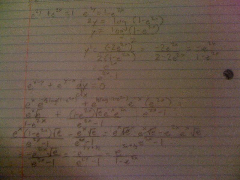

df606
"Determine whether the equations on the right define implicit functions of x. For those which do, determine whether they are implicit solutions of the differential equations on the left."
e^(x-y) + e^(y-x)(dy/dx) = 0, e^(2y)+e^(2x) = 1
Apologies for blurry camera picture, I still don't know latex.
I solved the right equation for y, then took the derivative, and plugged both back into the left equation. I've been looking at this for about half an hour and I can't figure out where I've gone wrong.
edit: the answer says that it is an implicit solution
You should probably try using implicit differentiation, like your title suggests. If e^(2x)+e^(2y)=1 then 2*e^(2x)+2*y'*e^(2y)=0 differentiating both sides by x, right? Solve for y' and substitute into the differential equation. It's often a lot easier then solving for y (which might not even be possible) and then differentiating.
Hi df606! :smile:
You wrote something like this two times:
e^{\frac{1}{2}\log(1-e^{2x})}=\sqrt{e}(1-e^{2x})
You seem to be doing e^{ab}=e^ae^b, which is of course incorrect. The correct formula is
e^{\frac{1}{2}\log(1-e^{2x})}=\left( e^{\log(1-e^{2x})}\right)^{1/2}=\sqrt{1-e^{2x}}
I did not check from there on...
Aha! Thank you micromass. I figured I was doing something like that. However, after doing what Dick suggested, the problem became incredibly simple, and I find it rather hilarious that I didn't try doing that earlier.
