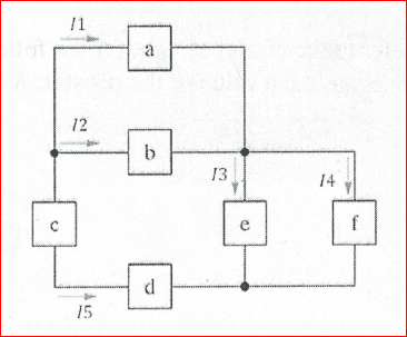

Ok good. I am stuck on #15 now. I'm haven't seen this kind of circuit yet, so I'm not sure how to apply kirchhoffs current law. I think A, B, and D are correct, but I'm not sure. I think all the squares in the circuit are power sources, but I'm not sure where to start in this circuit to make my loop and write out my equation.
Kirchoff's current law just says, for any point, the currents going into the point must equal those going out of the point. (You don't need to know anything about that kind of circuit to apply the law to each point.)
Do you know how to do screen shots, or use the snipping tool ? It's much more likely that you get help if we don't have to open new tabs/windows on our browser.
All that is required for this problem is to apply Kirchhoff's Current Law.
You do not need to know what the squares represent at all.
Hint: Write an equation for each point where wires connect. (The three dots in the diagram.) Then compare those equations with the choices given.
I'm having a hard time with this. How do you know what is going in and what is coming out exactly. All the currents can come out of one point. I was trying to write an equation for the point above box c, but how can I tell what is going in and out. Also, I thought current flows to the spot with least resistance.
Edit: Also, I think I would understand this there were 2 points/junctions, but how do I do this with three?
The currents have directions, specified by the arrows.
I know, but I still don't see how I can find my equations. This is a very weird circuit. It looks like you can have many possibilities. EX. i1=i3+i4-i2 or i2=i3+i4-i1 (these 2 are the same thing actually). i5=-i3-i4 or i3 = i5+i4 (not sure about this one).
You have four options. Check each option. You are asked to find which option(s) is(are) correct.
There are three 'junctions', each marked by a dot. So you can have three equations.
Good! But there's one more.
Now just check to see which of the given equations are consistent with those.
Doc Al said:
There are three 'junctions', each marked by a dot. So you can have three equations.Good! But there's one more.
One more? I can't find another. Re-arraging them i get A,B, and D fro my answers. i1+i2=i3+i4, i5=i1+i2, and i3+i4+i5=0
Do you agree that the diagram shows three junctions? Each one deserves its own equation.
Marcin H said:
i1+i2=i3+i4,
Good.
Marcin H said:
i5=i1+i2,
Almost, but not quite.
Marcin H said:
i3+i4+i5=0
Good.
Hmm. So am I missing an equation for the junction above box C? it looks like i1, i2, and i5 would be coming out of that junction. So Does that mean i1+i2+i5=0?
Exactly!

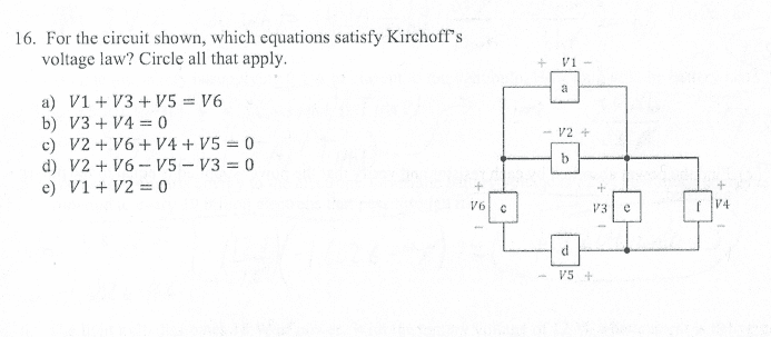

Ok. Did I do this problem correctly? I looked at the equations in the answers and then made loops that included those voltages and checked if they make sense. I don't know if this is the best way of looking at it. I think the correct answers are A, D, E.

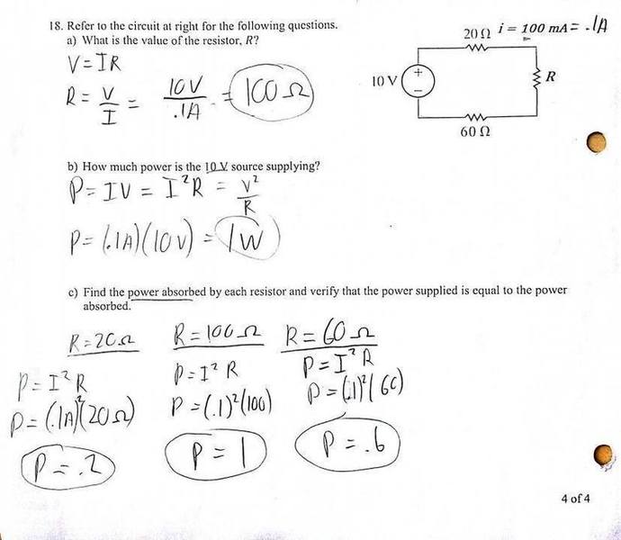

Also, quick side question about units. When using equations like P=IV or V=IR we use AMPS for our unit for current right? So if we are given 100mA we have to use .1A in the equation right?
Sounds good to me.

Couple more questions. I think I did 18A correctly, but it looks like I did something wrong in 18B and 18C. Shouldn't my three answers from (C) add up to 1W, my asnwer in (B)? Not sure where I went wrong here.
