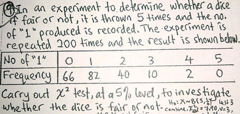

i have problem of finding the degree f freedom for this question. the ans for v is 3 , but my ans is v=n-1 , where n = 6 , so my v=5...
  • Handwritten question 9 on a chi-square test of whether a die is fair, with a table of the number of 1s thrown in 5 throws over 200 repeats: 0 to 5 ones with frequencies 66, 82, 40, 10, 2, 0.

For the Chi Squared test, there is a minimum frequency needed for it to be accurate. I would expect that some of the less frequent observations were grouped or "binned" together to reduce your operational "n".

Please type out the problem; you are not supposed to post thumbnails. (Read Vela's 'pinned' post called 'Guidelines for students and helpers', especially topic 4.) This morning I could not read your thumbnail on the medium I was using then.

the question contains boxes. if i type out , it would look weird... so i would rather post the image of the original question
Did combining the lower frequency observations solve your problem getting to v=3?
I think the general rule is frequency ## \geq## 5.

thanks! question solved!
