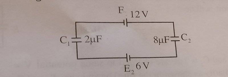

I want to find the charge and potential drop across each capacitor
Circuit schematic of a single loop with capacitor C1 (2 µF) on the left and C2 (8 µF) on the right, connected by a top branch containing battery E1 (12 V) and a bottom branch containing battery E2 (6 V).
I know both the capacitors are in series and hence have the same charge on them. However I don't know how to calculate the potential drop across the capacitors. Tried applying Kirchoff's laws, but I don't know whether there is a potential drop or rise across each capacitor so I don't know which sign to use. Different signs are giving different answers. Is it possible that this problem has multiple solutions?
If you showed your working, we can see where you went wrong.

If you apply Kirchoff's laws, say in an anticlockwise manner, the answer will depend on whether you assume the potential to drop or rise across either one of the capacitors or rise/drop across both capacitors

What is the direction of current? What is the net voltage in the circuit?

I want to solve this when it's in steady state so the current is zero

Yes, but to charge the capacitors, how should the current flow?
