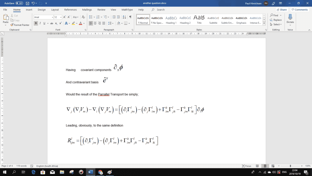

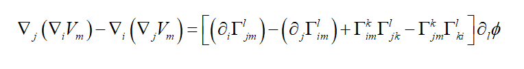

Given that the Riemann Curvature Tensor may be derived from the parallel Transport of a Vector around a closed loop, and if that vector is a covariant vector
Having contravariant basis
The calculation gives the result
Now:

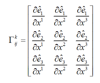

Given that the Christoffel Symbols represent the change in the basis vectors (rotations etc) as we move around the closed loop and given that mathematically this is given by
Can we represent the Riemann Curvature Tensor in terms of the basis
Thank You

Rule of thumb is if your tensor has one or more lower indices, then it cannot be written only in terms of the contravariant basis. In the case of the Riemann tensor, it goes like ##R = R^\mu{}_{\nu \sigma \rho} dx^\nu dx^\sigma dx^\rho e_\mu##.
The problem is if the curvatrue is not 0, then obviously we can not define a gobal basis vector ##e_\mu(x)## on the manifold.
but locally the change of basis vectors can be described using a matrix function ##A(x)## , then the connection can be expressed in such a way:
##\Gamma_i(x)\doteq \partial_i A(x)A^{-1}(x) ##

Thanks for you reply.
I agree that in the case of both upstairs and downstairs indices on the Riemann Curvature Tensor it cannot be written only in terms of contravarient basis. What if I was looking at

I agree with vanhees's points. I'd suggest re-writing (if possible) the original question taking into mind these points. And there are a few other things to clean up along the way. These points seem minor, but they reflect some errors in communication at minimum, and possibly some more significant errors.
Here the OP writes for some reason ##\partial_x \phi## , but I think it should be just ##\partial_x##. The partial derivative operator is a vector, it doesn't take an argument ##\phi##. More on this later.

If ##\phi## is a scalar field, so the vector field ## \partial_i\phi## is a gradient field , then the curl of the vector field is 0, But to an arbitrary vector field ##v_i(x)##, the curl is not always 0, So to an arbitrary vector field, it usually can not be expressed using a scalar field ##\phi(x)##.
Further more, if the curvature of a manifold is not 0, then the parallel transport of a vector on the manifold around a closed path will cause a change of the vector, so we can assert that it is impossible to get a vector field on the manifold, just as we can not define a globle vector basis on the manifold.
So I an afraid the Riemann curvature tensor can not be described using ##\partial_i\phi(x)## or ##\phi(x)##
