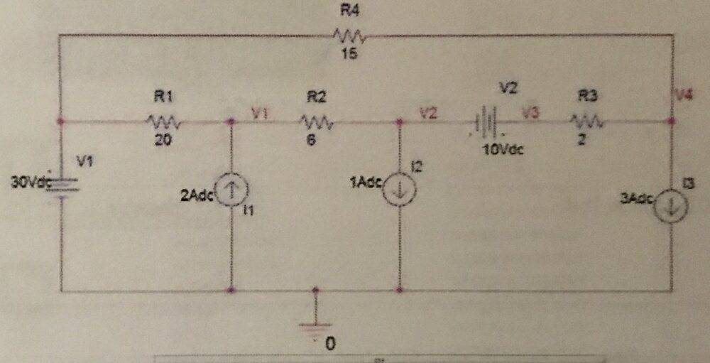

Find the value of V1, V2, V3, V4
None
*A is the node all the way to the left above the 30V but I didn’t end up using it because I don’t think you need it since the same as 30V, right? *
I know I messed up somewhere because shouldn’t V1-4 = 30? After finding my V1 I used that value to find the other Vs and it ended up being close to -1000V

I also find it confusing to see the black V1 in a different location than the red V1. I suppose the black one can be ignored.You may also want to apply KCL to a point B -- the minus side of the 30 V on the left
It's a nice try, thanks for showing us your work. However, there are several problems with the equations you've set up.
@A: (30-V1)/20 and (V4-30)/15 are currents, through R1 and R4. But 30 is the voltage at node A. It doesn't make sense to add up voltages and currents. Similar to the way in beginning physics problems you won't see Kg and meters summed in a formula. You can really only add up the same types of things.
@V2: You've correctly summed two of the three currents that can flow to that node. Or perhaps you assumed that the current through R3 is zero, without showing any justification for that.
I didn't review much more than this yet. I think you may be making too many evaluation steps at the beginning. Label the currents and make KCL equations at each node. In this network every node will have three currents, except V3 and the ground node which has four. Then in the next step describe each of those currents using the voltages and ohms law and substitute those into your KCL equations. Some currents will remain as variables, like the current through V1. Be careful to get the polarities correct. This will give you a set of equations to solve.
