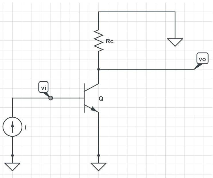

I write down step by step what I did for a very simple transresistance amplifier here and hope someone can point out what I did wrong:
The following is a very simple transistor I use as a transresistance amplifier example here:
Circuit schematic of a common-emitter NPN transistor stage Q with collector resistor Rc to ground, input node vi driven by current source i, and output node vo at the collector.

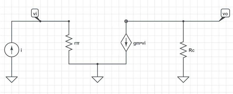

and the following is the corresponding π model assume output resistance r o = ∞ just to make it simple:
Small-signal pi-model circuit: current source i at input node vi feeding rπ to ground, dependent current source gm·vi, and load Rc to output node vo.

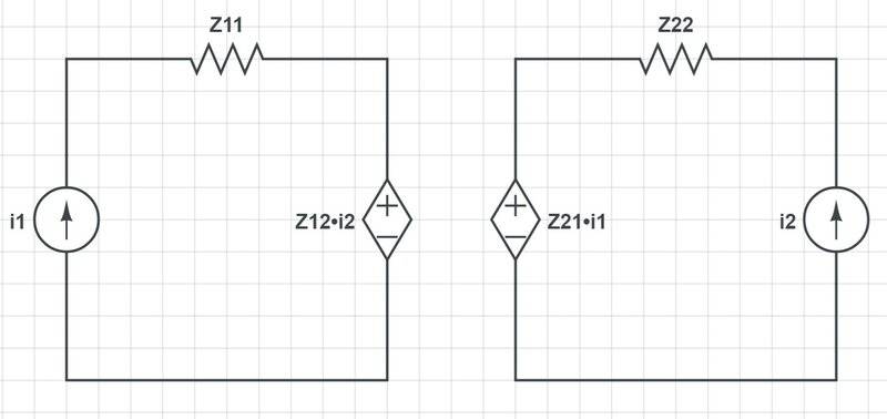

I converted the circuit to a z-parameters model as follows:
Two-port z-parameter equivalent circuit: left loop has source i1, series resistor Z11, and dependent voltage source Z12·i2; right loop has dependent voltage source Z21·i1, series resistor Z22, and source i2.

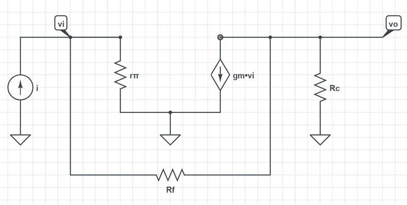

When I added feedback to the π model as follows:
Small-signal pi model of a transistor transresistance amplifier with feedback resistor Rf between output vo and input vi. Input current source i feeds node vi with rπ to ground and gm·vi dependent current source, Rc to ground at output.
and did nodal analysis, I got:
$$Nodal\ analysis:$$
$$1)\ i=\frac {v_i} {r_π}+\frac {v_i-v_o} {R_f}$$
$$2)\ g_mv_i\ +\frac {v_o-v_i} {R_f}\ +\frac {v_o} {R_C}=0$$
$$\Rightarrow \frac {v_o} {i}=\frac {-R_Cr_π(g_mR_f-1)} {R_C+R_f+r_π+g_mr_πR_C}$$

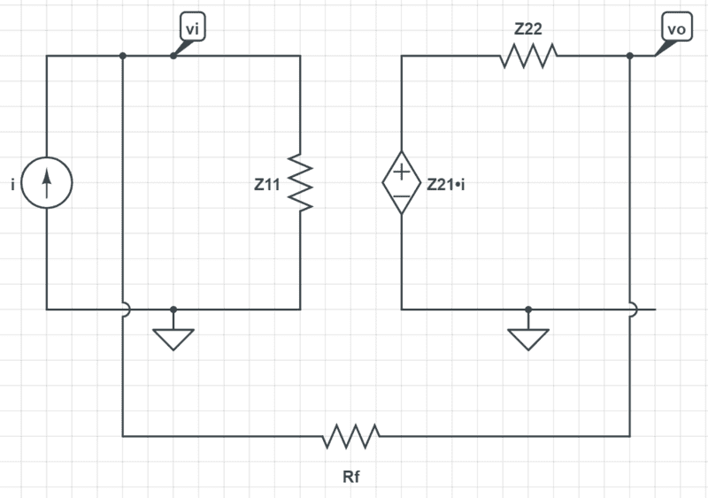

However, when added the same feedback to the equivalent z-parameters model as follows:
Circuit schematic of a two-port network: current source i at input node vi with shunt impedance Z11, a dependent voltage source Z21·i feeding series impedance Z22 to output node vo, and feedback resistor Rf connected between input and output.
and did nodal analysis:
$$1)\ \frac {-g_mr_πR_Ci-v_o} {R_C}=\frac {v_o-v_i} {R_f}$$
$$2)\ i=\frac {v_i-v_o} {R_f}\ +\frac {v_i} {r_π}$$
$$\Rightarrow \frac {v_o} {i}=\frac {-R_Cr_π(R_fg_m + g_mr_π - 1)} {R_C+R_f+r_π}$$
The results do not match. I really have no idea what I have missed. Any helps or pointers will be greatly appreciated!!

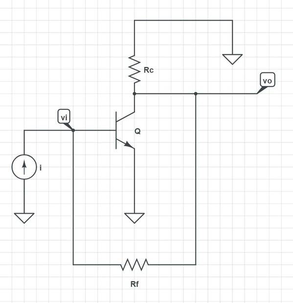

  • Circuit schematic of a transistor Q with a resistor Rc in the collector and feedback resistor Rf from the output vo back to the input node vi, driven by current source i.

I think I got it. I mixed up the current i1 going into the input port with the current source i
