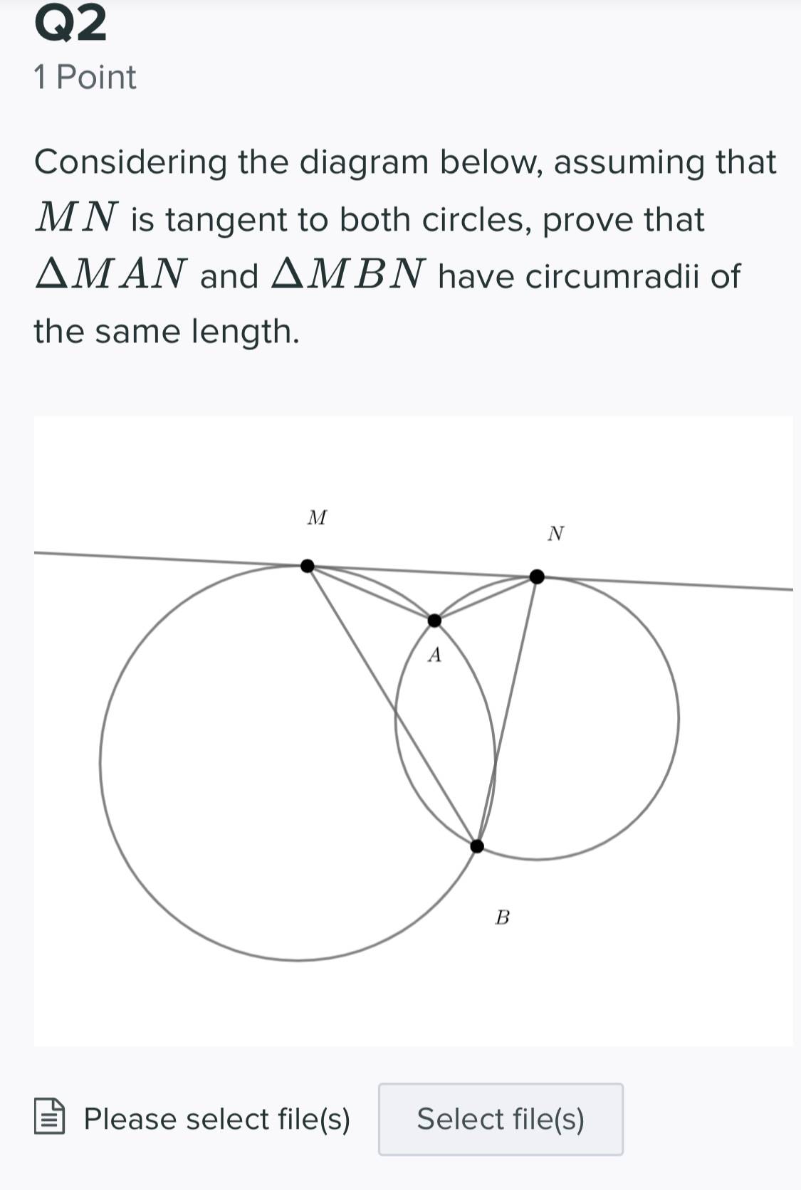

The discussion focuses on a geometric proof involving the rotation of a diagram through 180 degrees about the midpoint of segment MN, resulting in two new circles that intersect at points A' and B'. It establishes that the angles MBM and MAN sum to 180 degrees using the alternate segment theorem, thereby demonstrating that MA'NB forms a cyclic quadrilateral. The circumcircles of triangles MAN and MBN are shown to have the same radius, as they transform into each other upon rotation. This geometric relationship highlights the properties of cyclic quadrilaterals and their circumcircles. The proof effectively illustrates the interconnectedness of angles and circles in geometric configurations.
slwarrior64
Mathematics news on Phys.org
Rotate the diagram through $180^\circ$ about the midpoint of $MN$ to get two new circles, intersecting at say $A'$ and $B'$, so that $MANA'$ and $MBNB'$ are parallelograms. Use the alternate segment theorem in triangles $MAB$ and $NAB$ to show that angles $MBN$ and $MAN$ add up to $180^\circ$. Hence so do the angles $MBN$ and $MA'N$, and it follows that $MA'NB$ is a cyclic quadrilateral. So in the diagram below, the green circle (circumcircle of triangle $MAN$) and the red circle (circumcircle of triangle $MBN$) have the same radius: each of them goes to the other one when the diagram is rotated through $180^\circ$ about the midpoint of $MN$.
