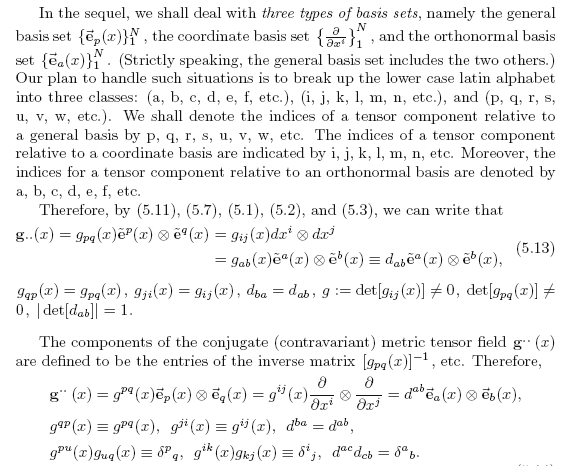

Hello every one , in this pic i just printed ( Tensors_The Mathematics of Relativity Theory and Continuum Mechanics by Anadijiban Das ) here the author classifies the basis into 3 types 1- is the general basis (non-holomonic ) , 2- coordinate basis ( holomonic ),3- orthonormal basis ( non- holomonic)
I know that the coordinate basis represent the natural basis like cartesian , spherical(orthogonal) or any general system(non-orthogonal) coordinate basis, and I know that the orthonormal basis represent the normalized basis from the coordinate basis ( i.e. unit vector )
My question , What do the general basis represent ?!
A set of vector fields is a basis if it is basis at each point in its domain for the tangent space at each point. If these vector fields are a coordinate basis then your book calls them holonomic. If there is an inner product then a basis that is orthonormal at each point your book calls an orthonormal basis.
But your question confuses me because this is what your book says.
It is perhaps easier to think of this at one point first, and just consider a single tangent space. A set of n-linearly independent vectors in an n-dimensional vector space defines a basis. This is a "generalized basis". The only property you require of a basis is that it is linearly independent and it spans the space (so n vectors for an n-dimensional space). A coordinate basis is a subset of such, arising from a coordinate system. This means that not only does a coordinate basis need to span the space, and be linearly independent, it needs to be associated with a smooth coordinate system, i.e. it must be ##\partial_\mu## for some system of coordinates ##x^\mu##. As it turns out, the necessary and sufficient condition to guarantee this is that all the Lie brackets between the different basis vectors must vanish. In other words, we must have ##[e_i,e_j]=0~\forall i,j##. This is an additional condition that we impose, and it limits the potential bases to a small subset. An orthonormal basis is a set of n linearly independent vector which is also orthogonal to each other, and normalized to length 1, these are the bases for which ##g_{ab}(e_i)^a(e_j)^b=\delta_{ij}##. This is a wholly different condition that we impose on our basis vectors, and it limits the potential bases to a different small subset.
On a flat manifold, it is possible for a basis to be both a coordinate basis and orthonormal (i.e. the Cartesian basis). But in a curved space, it is not possible to be both at once. So it is technically incorrect to associate "orthonormal basis" as "non-holonomic basis". Any basis which is NOT a coordinate basis is "non-holonomic". That includes, in a curved manifold, all the orthonormal bases and more.

I'm having a hard time understanding your question. A general basis is ANY set of n-linearly independent vectors in an n-dimensional vector-space. In a 2-D manifold, then, choose ANY set of 2 vector fields who are linearly independent at every point. That is a general basis.

A coordinate basis for the tagent space ##T_pM## at a point ##p## of an ##n##-dimensional manifold ##M##, is a basis of the form
$$\bigg\{\frac{\partial}{\partial x^1}\bigg|_p,\dots,\frac{\partial}{\partial x^n}\bigg|_p\bigg\},$$ where ##x## is a coordinate system. A "general" basis is just a basis whose elements may not be equal to the partial derivative functionals associated with a coordinate system.
If you normalize a coordinate basis, the result won't be an orthonormal basis unless the coordinate basis you started with was orthogonal.
