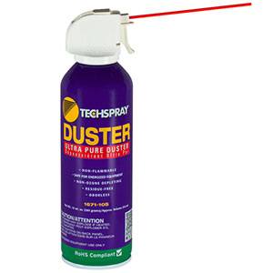

We have an optical equipment that has a narrow entrance slit, on the other end of the narrow entrance slit two rod lenses are exposed. They are getting dirty for various reasons. Does anybody know of any handheld air/vacuum cleaning with thin nozzle that can penetrate the slit and even remove dust particles accumlated on the lenses?

I would try this first:
http://www.thorlabs.com/thorProduct.cfm?partNumber=CA3
I already tried the air can technique but it seems that the nozzle is thicker in diameter and I can't insert it into the slit and thereby spray on the rod lenses.It seems i am just dispersing the dust around the area..Same is the problem with making physical contact w/ the lenses. It's hard to make physical contact without opening up the module. Would you know if a thinner nozzle is available w/ the dust can.
