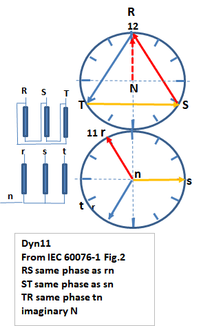

Hi,
I'm studying transformer and am a bit confused. Say for vector group: Dy11, I guess it's the line voltage of LV leads the Line voltage of HV by 30 degrees. Book says phase angle. The phase angle is line voltage right,
since the phase voltage of HV and LV will always be in phase with each other.
I googled up for it, but everywhere it says phase angle. Just wanted to clarify whether phase angle is angle between line voltage of lv and hv side.
Thanks in advance for the answers.

Yeah I've studied the equilateral triangle method and know the conventions of how to derive clock 11 or 1 or 0 or 6 from dot convention. But I guess the clock gives phase difference between line voltage of HV and LV. I'm confused here.
In star-delta transformer, there is 30 degree phase shift from HV line to LV line. This can be lead or lag depending on connections. So am I right in saying the clock(11 or 1) represents the phase difference between HV and LV line voltage?
Correct.
From http://www.transformerworld.co.uk/vector.htm
The digits ( 0, 1, 11 etc) relate to the phase displacement between the HV and LV windings using a clock face notation. The phasor representing the HV winding is taken as reference and set at 12 o'clock. It then follows that:
Digit 0 means that the LV phasor is in phase with the HV phasor
Digit 1 that it lags by 30 degrees
Digit 11 that it leads by 30 degrees
etc
All references are taken from phase-to-neutral and assume a counter-clockwise phase rotation. The neutral point may be real (as in a star connection) or imaginary (as in a delta connection)

IEC 60076-1 Definitions ch.3.10.6
Phase displacement of a three-phase winding
The angular difference between the phasors representing the voltages between the neutral point (real or imaginary) and the corresponding terminals of two windings, a positive sequence voltage system being applied to the high-voltage terminals, following each other in alphabetical sequence if they are lettered, or in numerical sequence if they are numbered.
The phasors are assumed to rotate in a counter-clockwise sense
Sorry,it has to be:
