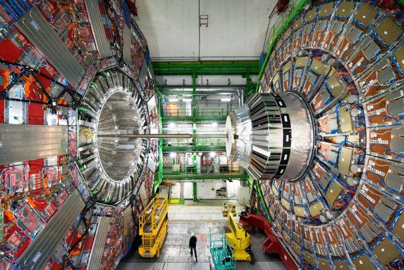

In this picture of CMS, there is a huge gap between the two sides. There is no way that the collision occur directly in midair right?
So is the gap already been sealed? ( which means the picture was taken before it started to operate) Or I am completely wrong?
  • Photo of the CMS detector at CERN during assembly, with its two end halves separated and a worker standing on the floor between them, showing the cylindrical structure, cabling and scaffolding.
You see CMS during a maintenance phase where the detector was opened to access it. This typically happens every winter, with longer shutdowns (for 1-2 years) every few years.
During collisions it is closed.
Thanks! I am correct for the first time! By the way, I got another question: when the maintenance is over, are the detector’s two halves brought together to seal the gap or an extra section is removed while mainiainance and installed back afterwards?(Since I didn’t see any sign of some sort of rail mechanism which makes the two halves moveable)
