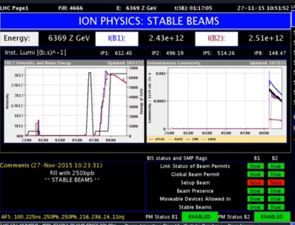

The Pb beams in Run 2 have been 6.37 Z TeV per ion for some reason.
