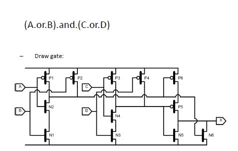

The discussion centers on the implementation of the logic function (A OR B) AND (C OR D) using CMOS gates. The circuit described utilizes NAND gates formed by P1, P2, N1, and N2, as well as NOR gates formed by P5, P6, N5, and N6. The output of the first stage is the NAND operation, followed by a NOR operation that combines the results, confirming that the circuit effectively represents the desired logic function. The final output is expressed as A.B.C.D, demonstrating the equivalence of the circuit to the original logic function.
