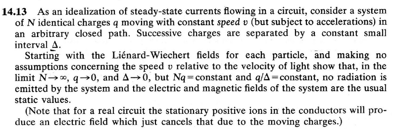

No it does not. A single charge traveling in a loop does radiate due to it's centripetal acceleration. But a vast number of closely-spaced charges moving in a loop (i.e., a macroscopic electric current) does not radiate, due to cancelations between the charges. (This follows from the math that you don't want to see!)

The answer to your question follows from solving this textbook problem from J.D. Jackson, Classical Electrodynamics (2nd ed.) involving Liénard-Wiechert potentials arising from ##N## equally-spaced charges:
You can likely find the full solution posted somewhere online.
