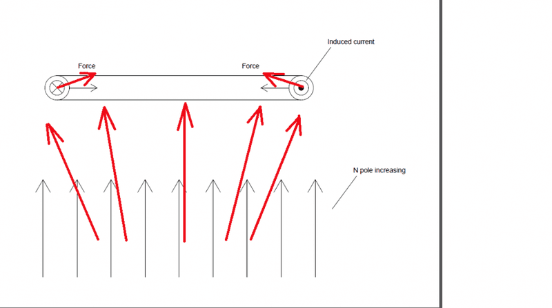

Hi,
can someone explain me the next experiment:
If I have an AC coil on iron stick, and if I put Cu ring on that stick concentric with AC coil, when I turn coil power supply, the ring will levitate on some height. My question is:
Powered AC coil produces an AC magnetic field. If I put a closed conducting loop (Cu ring) in that magnet field, in the ring will be induced current (Faradey law) in such direction to opposes magnetic field from AC coil (Lenz law). But in first quarter (N pole increasing) of sine wave of magnetic field from coil, the ring and and the coil will reject each other. In second and third quarter of a sine wave (N pole decreasing, and S pole increasing), the ring and the coil will attract each other. And in forth quarter of sine wave (S pole decreasing) the ring and the coil will reject each other again. Base on this I can conclude that the ring should stay in one position and should oscillate. Where is my mistake?

Actually, it induces EMF which is equal to the rate of change of the magnetic flux enclosed by the loop. So, if your flux is proportional to ## sin(\omega t) ##, the induced EMF will be proportional to ## - cos(\omega t) ##. But a loop is an inductor with one turn and due to loop inductance, the induced current will be lagging the EMF and proportional to ## - cos(\omega t - \phi) ##. If the resistance of the loop is very small compared to its inductance, the lag angle ##\phi## will be close to 90 degrees and the induced current will be almost in phase with the primary magnetic field. That's what gives the repulsion.

There is one more thing about electromagnetic forces between the ring and the coil. Let's say that I have DC power supply for a coil. When i turn on power supply i'll have increasing magnetic filed which will induce current in the ring. The induced magnetic field is in opposite direction of coil field. When I draw the lines of forces (Lorentz law), i can find that the ring shouldn't go from the coil but it want's to decrease its surface.
On the other hand, when I have, for example, N pole on coil and N pole on the ring, these two objects should reject each other, as experiment shows?
Can you draw me the lines of forces and explain me this situation?

Let's have a look at period while DC current is increasing (turning on DC power supply). The effect of that is increasing magnetic field. In this period the field is not constant, but increasing. In the ring will be induced increasing current in such direction to oppose the increasing field. For example, the coil in this period produce an increasing N pole up, the ring will also produce increasing N pole down to oppose coil field. When I draw the lines of forces, they acts in direction to decrease radius of the ring.
But when look logically if I have N pole on coil and N pole on a ring they should reject each other...But I can't find out how forces acts? It confuse me...

My apology. After I replied to your post, I realized that I forgot to mention an important factor.
My first reply dealt only with time dependence. What I forgot to say was spatial dependence.
Your drawing is correct. If the field is uniform, you don't get a force on the ring to push it out, only the force that tries to squeeze the ring.
In real situation, the field is not uniform which means there will be a radial component to the field. And this field non-uniformity is what is needed to get a net force on the ring. I don't have a good drawing software, so I just added a few vectors to your drawing. It does show that you need a field non-uniformity to get the force on the ring.
