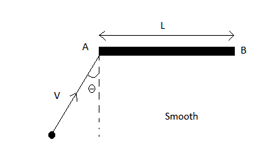

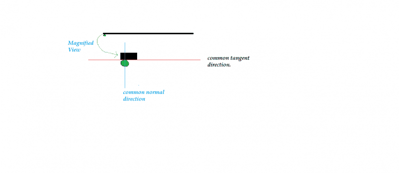

A thin rod AB of mass ##m_{1}## and of length ##l## is placed on a smooth horizontal ground. A point sized particle of mass ##m_{2}## having a velocity ##v## making an angle ##\theta##with the line perpendicular to ##AB## collides with the rod at point ##A##.
Assuming the collision to be elastic find ##\theta## such that the point sized particle again collides with the rod at point ##B##.
T[/B]he image was provided with the question.
When two things collide equal and opposite impulses acts along the direction perpendicular to the contact surface. So in this situation if the particle collides with rod at point A then the impulse which acts on the rod passes through the CoM of the rod. So no impulsive torque acts on the rod about its CoM. So the rod will not rotate. And without rotating, it is not possible for the particle to collide again at point B. :mad:
So, how this can be solved?
No, why do you think so? The particle collides with the side of the rod near the end, not with the cross-section.

OK. But it is given that we have to assume that the particle is point size and the rod is thin. So if that particle collide at the ##edge## we have to assume that edge to be point (because rod is very thin). So how common normal direction can be drawn perpendicular to the contact surface. So I have assume that it collides little bit to the right of the edge.
I think velocity of the CoM of the rod will be in vertical direction because the impulse acts in vertical direction only.
As the collision is elastic so ##e=1##.
So we can equate the Velocity of approach and velocity of separation in common normal direction.
##V_{app}=v cos\theta## and ##V_{sep}=V+\frac{l\omega}{2}+v_{0} cos\alpha## (##\alpha## is the angle between ##v_{0}## and the common normal direction.
As no force in common tangent direction so ##v sin\theta=v_{0} sin\alpha##
Impulse acting on the particle is equal ti its change in velocity in the common normal direction. right?
So ##J=\triangle V##
So ##J=-m_{1}(v_{0}cos\alpha+vcos\theta)## (Considering downward direction as -ve).The same impulse acts on the rod.
##{ \tau }_{ imp }=\frac{l}{2}J## (##{ \tau }_{ imp }## is the impulsive torque)
This impulsive torque is equal to the change in the angular momentum of the rod. right?
So ##\frac{l}{2}J=L_{f}##
or ##\frac{l}{2}J=I\omega##
Is the impulse due to collision is equal to the change in the momentum of the CoM of the rod?
If yes then ##J=MV##
Am I right till here?

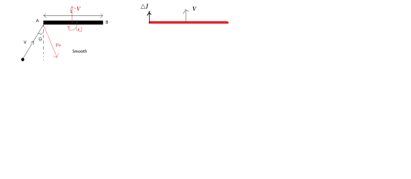

Really?
phinds said:
Really?
If that particle collide at the edge we have to assume that edge to be point (because rod is very thin). So how common normal direction can be drawn perpendicular to the contact surface. So I have assume that it collides little bit to the right of the edge. Is it fine to do so?
During collision equal and opposite impulse acts in the common normal direction. So impulse acts in the vertical direction.
You are treating the point of collision as though it was not part of the rod. No, it is not fine to do so.
I don't get you.In the diagram I have shown that the particle collides with the rod so the point of collision lies on the rod.
Yeah, I expressed that badly. What I'm trying to point out to you is that you have to treat the rod as a macro object. You hit the rod at an angle and then you are totally ignoring the angle by somehow deciding that it doesn't matter and that you can just throw away the horizontal component of the strike force. That's why I asked you in post #2 if you understand force vectors.

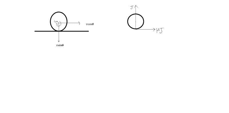

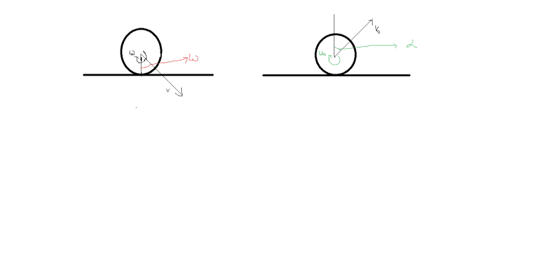

So are trying to say that I am neglecting the horizontal component of impulse. I have a confusion. During collision equal and opposite impulse acts in common normal direction.right? Isn't this true for macro object?
Assuming the collision instantaneous, the tangential force (friction) between the rod and particle can be ignored.
The rod can be considered very thin, practically one-dimensional, like a line segment, and the particle arrives at the line segment very near of the end, and rebounds from it. You can take the force of interaction perpendicular to the line representing the rod. The tangential component of momentum of the particle does not change during the collision. The normal components of the momenta do change, both that of the particle and the rod while the total momentum of the system is conserved.
The angular momentum of the whole system is also conserved. The particle has some angular momentum with respect to the CoM of the rod. It will be different after the collision, and the rod gains some angular momentum.

In case of instantaneous collision, you can ignore friction even then when it exists.
It's not relevant to this question, but that statement is not correct.
In an oblique impact, the normal impulse being J, the tangential impulse is up to ##J \mu_s##. What happens past that is an interesting question. Does ##\mu_k## come into play?
You are right, as always.:) I think the tangential force would be impulsive, too, and would change the tangential velocities.
Fortunately, the problem says that the collision is elastic, so there is no friction.

By conservation of energy I got
##\frac { 1 }{ 2 } m{ v }^{ 2 }=\frac { 1 }{ 2 } M{ V }^{ 2 }+\frac { 1 }{ 2 } I{ \omega }^{ 2 }+\frac { 1 }{ 2 } m{ v }_{ 0 }^{ 2 }##
By conserving angular momentum about the CoM of the rod I got
##\frac { mvlcos(\theta ) }{ 2 } =-\frac { m{ v }_{ 0 }lcos\alpha }{ 2 } +I\omega ##
Considering 'clock' as -ve.
Here ##m## and ##M## are the masses of the particle and rod respectively.

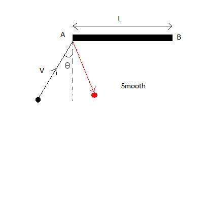

What is the condition necessary for the particle to collide again at point B? I know that point B and particle must be at same place at a given time. But I don't know how to frame this constraint equation.

Yes, that concept applies to this problem. It can take the place of the equation for conservation of energy.
OK
The signs can be a headache. Are you taking ##\omega## to be a negative quantity if it is clockwise? Anyway, double check that you have the signs correct. Also, keep in mind that the particle need not "bounce back". It might retain an "upward" component of velocity after the collision.
It might be good to consider things from the reference frame of the CM of the rod after the collision.

How to get that constraint equation?:confused:
After the collision, what do the trajectories of the particle and point B of the rod look like in the frame of reference of the CM of the rod?

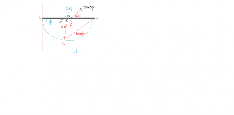

I got velocity of particle (let it be M) wrt CoM is ##{ v }_{ 0 }sin\alpha \hat { i } -{ (v }_{ 0 }cos\alpha +V)\hat { j }##
So ##tan\phi =\frac { { (v }_{ 0 }cos\alpha +V) }{ { v }_{ 0 }sin\alpha } ##.
Where ##\phi## is the angle between velocity of the particle and Y axis.
And the point B moves in a circle around with radius ##\frac{l}{2}##.
Should I use calculus to find relative velocity at any time 't' and then find its projection along the distance between M and B at that time and then express this velocity as dx/dt and then integrate within proper limits. But I think that equation will contain lots of extra variable.
Did you mean X axis here?
That does sound messy.
I would think about where the particle crosses the circular trajectory of B.
First find the expressions for the unknown vo, α, V, and ω in terms of the known data.
The particle moves along a straight line, with constant velocity, starting from (-L/2, 0). B moves around the origin, along a circle of radius L/2. The line intersects the circle. Where? From the point of intersection, you can find theta in principle.
