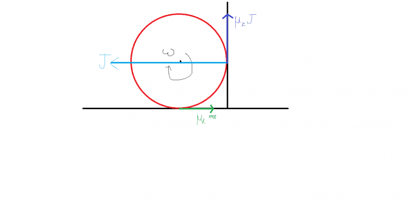

I have a question regarding impulse.
Suppose at a certain point of time ball has velocity ##vcos\theta## in horizontal direction and ##v\sin\theta## in vertical direction (downwards) and angular velocity ##\omega## in clockwise direction. Suppose if the coefficient if restitution of the ground to be ##e## and coefficient of friction to be ##\mu##. I am wondering what will be there horizontal and vertical components of the velocity of the ball after collision.
In common normal direction I can use ##v_{separation}=ev_{approach}##.
Let ##V_{x}## and ##V_{y}## be the final velocity in X and Y direction respectively.
So ##V_{y}=evsin\theta##...(1)
So ##J=m(ev sin\theta+v sin\theta)##...(2)
So in horizontal direction impulse is ##\mu m(ev sin\theta+v sin\theta)=J_{x}##....(3)
So ##J_{x}=V_{x}-vcos\theta##.....(4)
Now impulsive torque is ##RJ_{x}##
So ##RJ_{x}=I(\omega_{f}-\omega)##....(5)
From equation 3 and 4 we can find ##V_{x}##. But it doesn't depends on ##\omega##. This sounds strange to me. I think I have done a mistake. Am I correct?:confused:
  • #48

  • #49
TSny said:
I believe your conclusion is correct as long as you assume that there is pure slipping throughout the contact of the sphere with the surface so that Jx = -μJy. Here μ is the coefficient of kinetic friction.
However, it is generally not true that you will have pure slipping where Jx = -μJy. For example, a rubber ball hitting a rough surface will tend to "grab" the surface and you cannot model it as pure slipping. Generally, the final value of vx will depend on the initial spin of the ball. I think it can get very complicated.
So ,it is not essential that the ball slides on the surface it can even roll on it.
I think we can conserve angular momentum about the contact point even if ball rolls or slips. right?
##Rvsin\theta+I\omega=Rv_{0}sin\alpha+I\omega_{0}##
Considering clockwise as +ve.
Suppose if the coefficient of kinetic and static friction are equal then friction acting on the ball in either cases will be ##\mu J##. right?
But I think I am going to end up as same equation as in last post. I don't see any way to deal with this situation.Thanks for the help TSny.:)

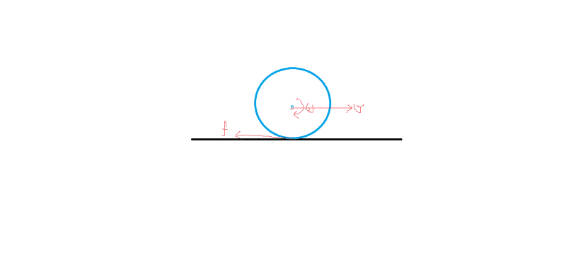

  • #50
Imagine that you kick a ball towards a wall perpendicularly. The ball rolls before hitting the wall. There is friction between the wall and the ball. What happens during the impact? What forces are exerted on the ball? How will it move after the impact?
An oblique collision can be quite complicated, as the relative velocity between the surfaces in contact is not horizontal if the ball rolls.
And both the ball and the wall are elastic to some degree. Interesting things can happen during the impact!

  • #52
Satvik Pandey said:
As ball collides the velocity of it's CoM changes it's direction but the angular velocity doesn't.
What impulsive torque acts on the ball during impact? Does it not change the angular velocity? How does it accelerate the CoM of the ball?
  • #53
The impulsive torque will be ##\mu_{k}JR=J_{y}## in anti clockwise direction. I have neglected the friction force at the bottom. I think it will be too small as compared to ##\mu_{k}JR##. Can we do that? I have written a wrong statement. The angular velocity changes but I assume the direction of final angular velocity same as the initial.
So ##\omega_{f}=\omega-\frac{\mu_{k}JR}{I}##
Let ##V_{y}## be the final velocity of the ball in Y-direction.
So ##V_{y}=\frac{\mu_{k}J}{m}##
  • #54
Will the ball bounce up a bit during the impact? I think it will. We need to do some experiments :)
  • #55
But that doesn't effect the final velocity in Y direction (it will remain same as ##\frac{\mu_{k}J}{m}##).right?
  • #56
If the ball both rotates and slips during the impact, you do not know the direction of the relative velocity of the surface in contact with the wall. The force of friction opposes that relative velocity, but you do not know the direction.
And think of the tennis ball in the video. Nothing is sure what happens during an impact.

I have a confusion regarding pure rolling motion.
In figure the ball's CoM has ##v## velocity and angular velocity is ##\omega##. For pure rolling motion ##v=r\omega## must be true. Here there is +ve angular acceleration due to friction force but -ve acceleration of ball's CoM due to that force. In ##dt## time the angular acceleration will increase and velocity of ball's CoM will decrease. So the equation ##v=r\omega## will not hold for long.:confused: Where am I wrong in the logic?
  • #58
In case of pure rolling with constant velocity the friction is static, and the force of friction is zero.:)
  • #59
Thank you! I got it. That was a silly question.o0)
